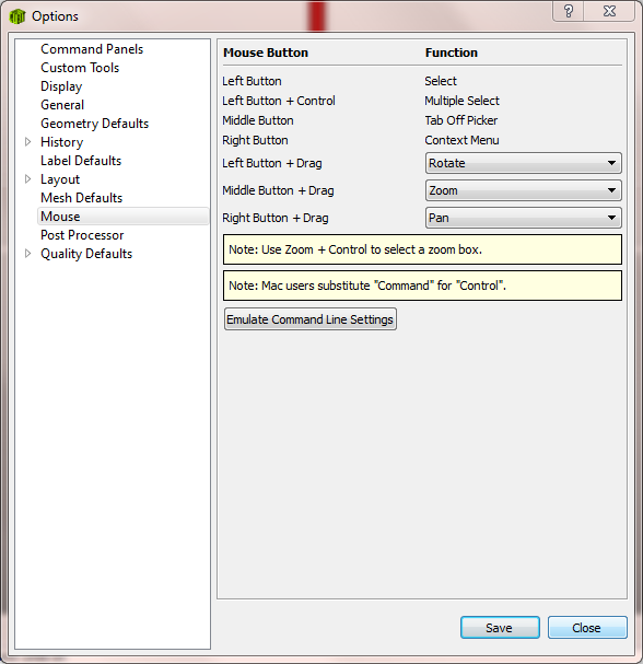

The GUI Options panel for managing the mouse bindings can be found at Tools/Options/Mouse, and is as follows:
