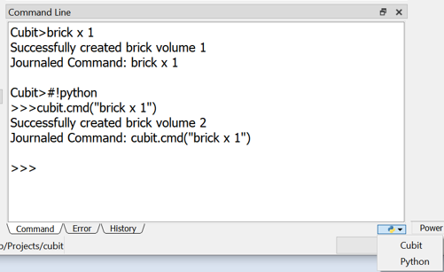

Command Window
The command line workspace emulates the environment in the command line version of Coreform Cubit. Commands can be entered directly by typing at the CUBIT> or >>> prompt. This window also prints out error messages, informational messages, and journaled commands.
Entering Commands
To enter commands in the command line workspace, the command window must be active. Activate the command window by clicking anywhere inside the window. Commands are typed in at the Cubit> or >>> prompt. If you do not remember the specific Cubit command sequence you can type help and the name of the command phrase. The input window will show all of the commands that contain that word or phrase. Alternatively, if you know how a command starts, but do not remember all of the options, you can type ? at the end of the command to show all possible command completions. See Command Syntax for an explanation of command syntax rules.
Command Mode
The command window can be in either a Cubit command mode or a Python statement mode. Switching modes can be done with #!cubit to switch to the Cubit command mode or with a #!python to switch to the Python statement mode. A convenience button is also available in the lower right corner of the command window to switch modes with a click of the mouse button.

The interface between Cubit and Python is the 'cubit' object. Among many methods, this object has a method called cmd which takes as an argument a Cubit command string. Thus the following command can be issued in the Command window at the >>> prompt, which will create a cube with sides 10 units long.
cubit.cmd("create brick x 10")
