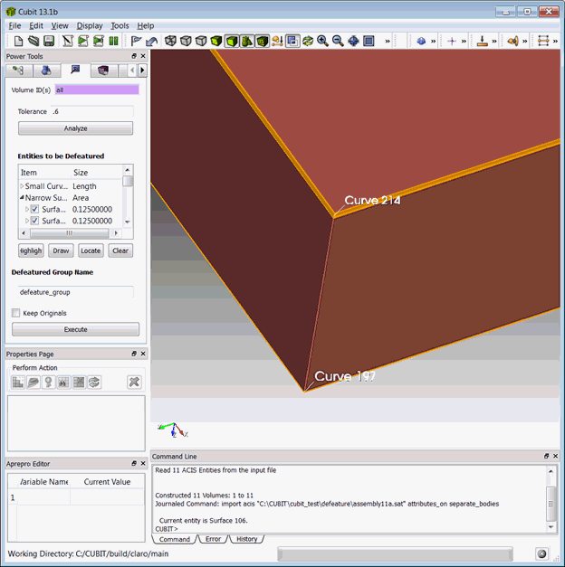

Figure 1 - Defeature Power Tool

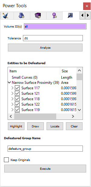

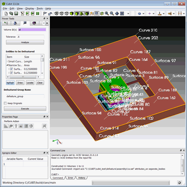

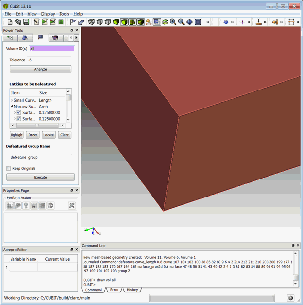

Step 1 requires specifying volume ids (e.g. all) and a tolerance (e.g. 0.6) as shown in Figure 1.  Clicking “Analyze” button will automatically find small curves and surfaces in the volumes specified.  Figure 2 shows the highlighted small curves and surfaces with the label information.   Figure 3 shows a zoom view of a small surface.
In Step 2 the user is allowed to deselect entities by unchecking entities from the list “Entities to be Defeatured”.  Users can also use “Highlight”, “Draw”, and “Locate” buttons to examine the automatically detected entities (see Figure 2).

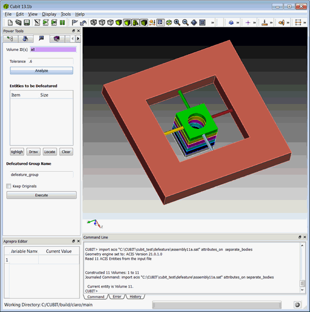

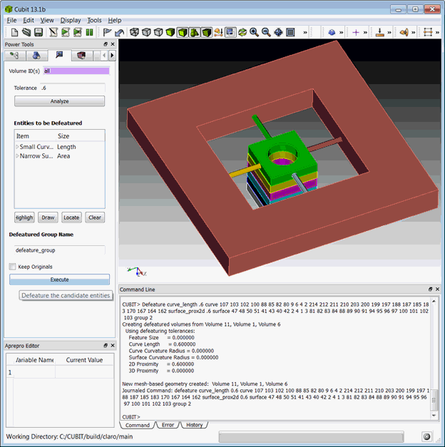

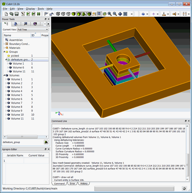

In Step 3 actual defeaturing is performed by clicking the “Execute” button (see Figure 5).  Figure 4 shows the zoom view of a defeatured volume.  Defeatured volumes are created in a new user specified group (by default in “defeature_group”) as shown in Figure 6.  Only the volumes that have small curves and surfaces will be defeatured.  Also, by default old original volumes are deleted and new defeatured volumes (child entities) will use the corresponding old ids.  Please use the option “Keep Originals” if you want to have both old original and new defeatured volumes.

Figure 1: Specify Volume ID and Tolerance before clicking “Analyze”
Figure 2: Use “Highlight”, “Draw”, and “Locate” to visualize small curves and surfaces
Figure 3: Zoom view of a small curve and surface
Figure 4: Zoom view of defeatured volume
Figure 5: Click Execute button to Defeature automatically/manually selected entities
Figure 6: New defeature_group contains defeatured volumes in MBG format
