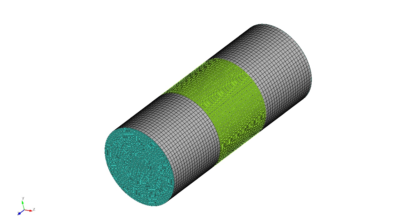

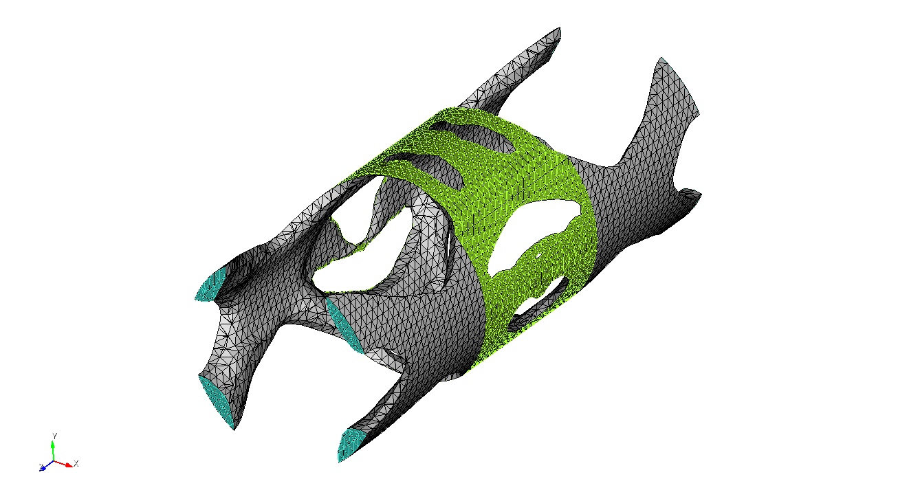

Transfer Nodesets and Sidesets
The capability shown in the below figure automates the transfer of sidesets and nodesets from the source mesh (e.g. design domain model) to the target mesh (e.g. topology optimized shape). Transfer of sidesets and nodesets was a user-intensive, error-prone, bottleneck as users were required to go through the painful step of manually selecting elements to define equivalent sidesets on the target mesh.
Source Mesh with BC
Target Mesh with BC
The commands to automatically transfer nodesets and sidesets are given below:
transfer nodeset <ids> onto {tri <ids> |face <ids> |tet <ids> |hex <ids> } [tolerance <value> ]
transfer sideset <ids> onto {tri <ids> |face <ids> |tet <ids> |hex <ids> } [tolerance <value> ] [log]
tri <ids> and face <ids> : if the target mesh is a surface mesh, use tri or face option.
tet <ids> and hex <ids>: this option can be used and the boundary skin mesh of the volumetric mesh will be extracted automatically to associate skin elements and nodes to the sidesets and nodesets, respectively.
tolerance <value>: The tolerance option must be used only if the default smart local tolerance doesn’t give the desired results.
log : The log option outputs the area of sidesets in source and target meshes and the ratio of the areas. The below table shows an example output. For example, the area_ratio can be used to adjust the pressure boundary conditions to maintain same forces.
Log output of transfer sideset command
sideset_id old_area ID new_area area_ratio ID
1 56.4843 4.8099 0.09
2 94.2209 68.4337 0.73
