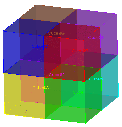

Coreform Cubit automatically propagates names through webcuts. If an entity that has been assigned the name "Gear" is split through webcuts, the resulting bodies are named "Gear" and "Gear@A". Try the following example.
br x 10
volume 1 name "Cube"
webcut volume 1 xplane
webcut volume 1 2 yplane
webcut volume 1 2 3 4 zplane
label volume name
Figure 1. Name Propagation through Webcuts
You can operate on these propagated names using wildcards such as:
mesh volume with name 'Cube*'
block 1 volume with name 'Cube*'
