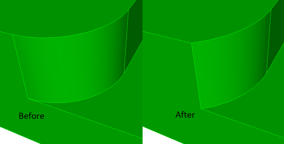

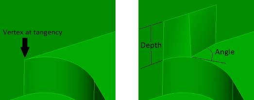

As shown in Figure 1, the depth parameter controls the depth of the surfaces that replace the tangency, while the angle parameter controls the resultant angle of the new tangency. Figure 2 demonstrates the behavior of the remove_material option which removes material instead of adding it.
Figure 1. Blunt Tangency Operation
Figure 2. Remove Material Option

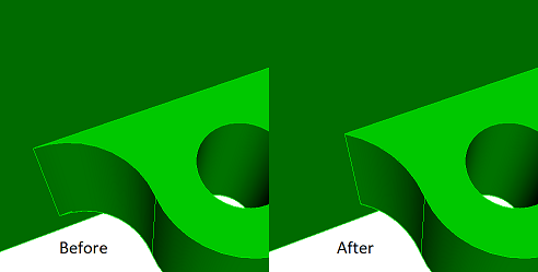

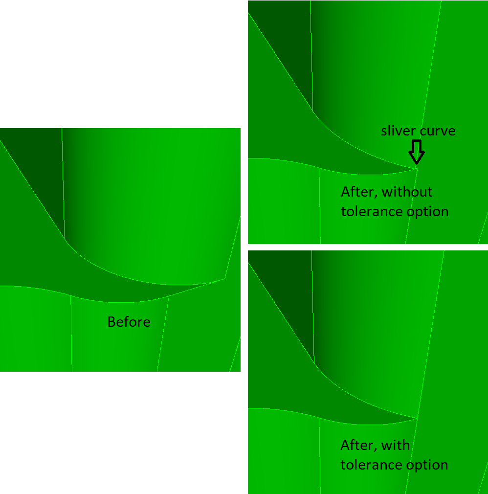

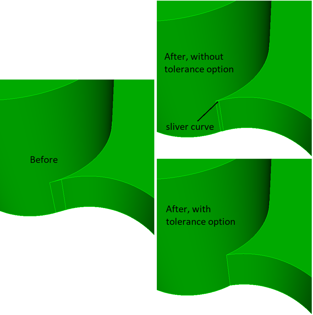

The second form of the command replaces the surface with the radius at the vertex with a larger radius surface, increasing the angle. The command tweaks the surface that results in the least amount of material removed (Figure 3) or added (Figure 4). The angle option works the same as in the first form of the command. The tolerance option prevents small curves from being created, snapping to adjacent vertices within the tolerance (Figure 5) or possibly modifying an adjacent surface (Figure 6).
Figure 3. Blunt Tangency Tweak -- Material Removed
Figure 4. Blunt Tangency Tweak -- Material Added
Figure 5. Blunt Tangency Tweak -- Tolerance
Figure 6. Blunt Tangency Tweak -- Tolerance
