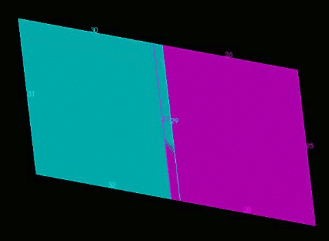

The filter_sliver option will remove false positives from the list by weeding out sliver surfaces that have a merged curve between them. The following pictures is an example of a sliver surface.
Figure 1. Example of a sliver surface
If curves 27 and 29 are merged before you run the find overlapping surface checkthe user will get the two surfaces in the picture as an overlapping surface pair. However, if the filter_sliver keyword is used, Cubit will not find the two surfaces to be overlapping.

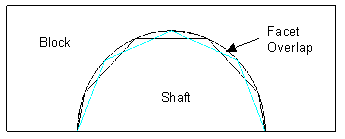

Tolerance - two individual facets must overlap by more than this area for a match to be found. Consider the two cylindrical curves at the interface of the shaft and the block in Figure 2. Note that some of the facets actually overlap, even though the curves will analytically be coincident. You can filter out false matches by increasing the overlap tolerance area.  The default value for this setting is 0.001.
Set Overlap Tolerance <value>
Figure 2. Possible false find due to overlap (tolerance will prevent finding match)
