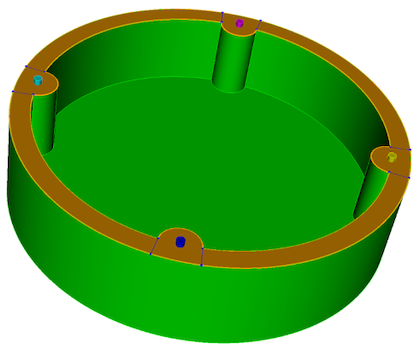

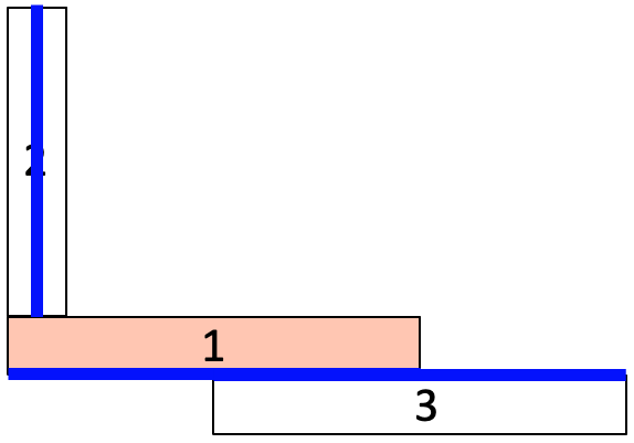

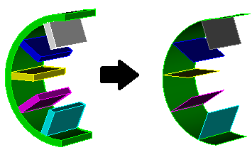

Reduce Thin Volume | reduce volume <id_list> thin auto | Reduces the thin 3D volumes to a connected set of 2D shell surfaces | ![]() |
Reduce Thin Volume RL | reduce volume <id_list> thin RL | Uses machine learning and reinforcement learning to reduce thin 3D volumes to a connected set of 2D shell surfaces. See also Beam and Shell Modeling with the Geometry power Tool | ![]() |
