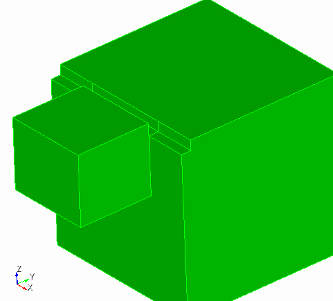

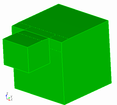

tweak remove_topology curve 19 small_curve_size .21 backoff 1.5
Figure 1. Tweak Remove Topology command
