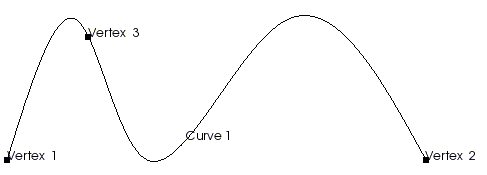

2. On Curve - Fraction: A vertex can be positioned a certain fraction of the arc length along a curve using the second form of the command.
Create Vertex On Curve <id> Fraction <0.0 to 1.0> [Color <color_name>]
Vertex 3 in the following example was created with this command:
create vertex on curve 1 fraction 0.25 from vertex 1
Figure 1. Create Vertex a Fraction of the length of a Curve
