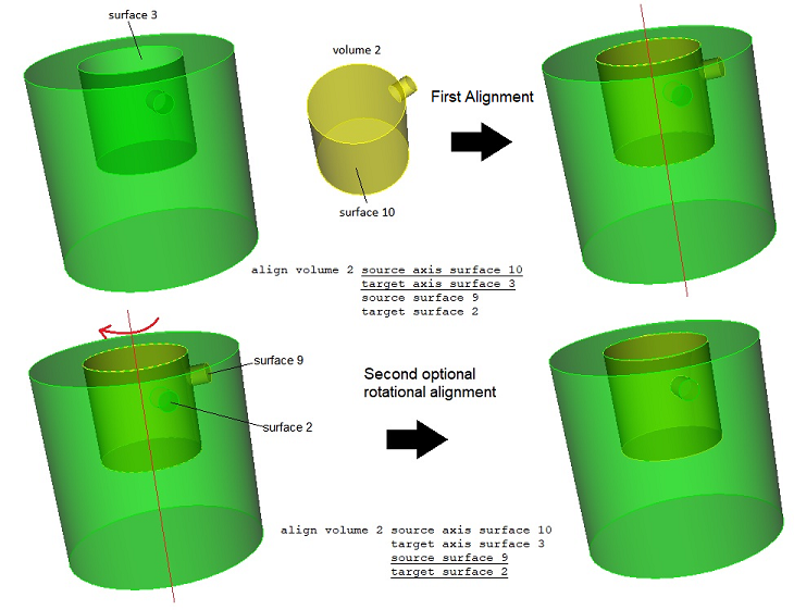

The image below shows the two alignments that occur when the additional source-target pair is specified.
Figure 1 - Aligning with optional rotation
