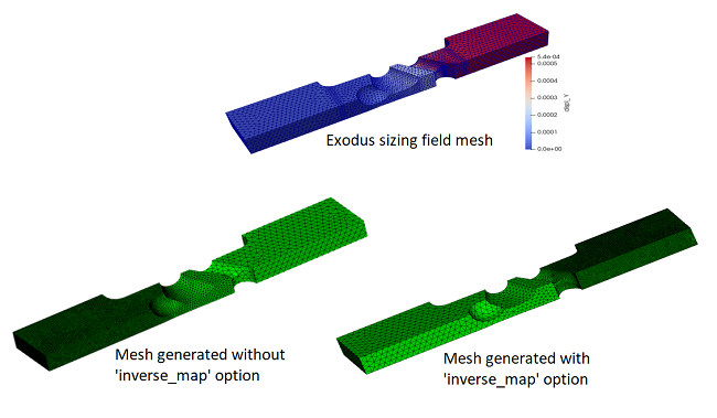

Inverse_Map flips the mapping so that smaller and larger values in the mapping generate larger and smaller elements respectively. See figure 1 below.
Figure 1. Effect of 'inverse_map' option
