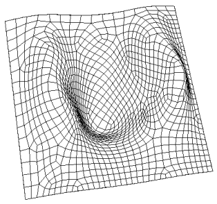

Figure 1. NURBS mesh with no sizing function, 34 by 16 density

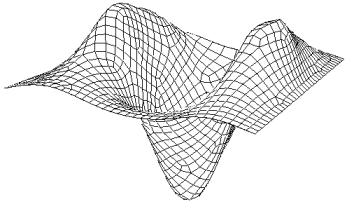

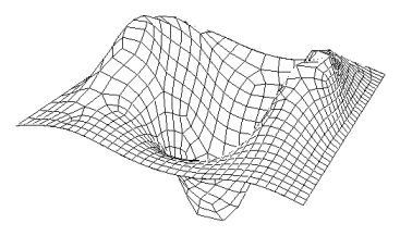

Figure 2. NURBS mesh with linear sizing function, 34 by 16 density
