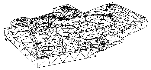

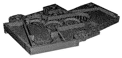

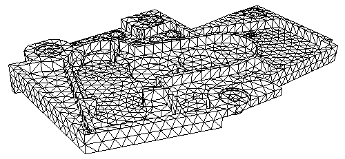

Vertices are not valid in the geom_list for this command.  Automatic interval size assignment works by examining the geometric characteristics of the entities in the geom_list and assigning a heuristic size to the entities and their child entities. The factor may be a floating point number between 1.0 and 10.0, where 1.0 represents a fine interval size and 10.0 represents a coarse size. Figure 1 shows an example of different auto size specification on a CAD model.
(a) auto size factor = 7.0
(b) auto size factor = 5.0
(c) auto size factor = 1.0

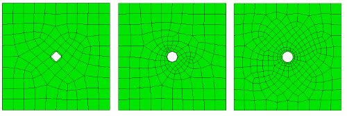

The angle parameter must be a positive value less than 360. The maximum arc span setting will only be used if there is not already a user defined interval set on the arc, and if the interval setting produces mesh edges which exceed the maximum spanning angle. Figure 2 shows the effect of three different maximum arc_span settings on a small hole using the pave scheme.
Figure 2. Maximum arc_span settings of 90, 45 and 15 degrees respectively.
