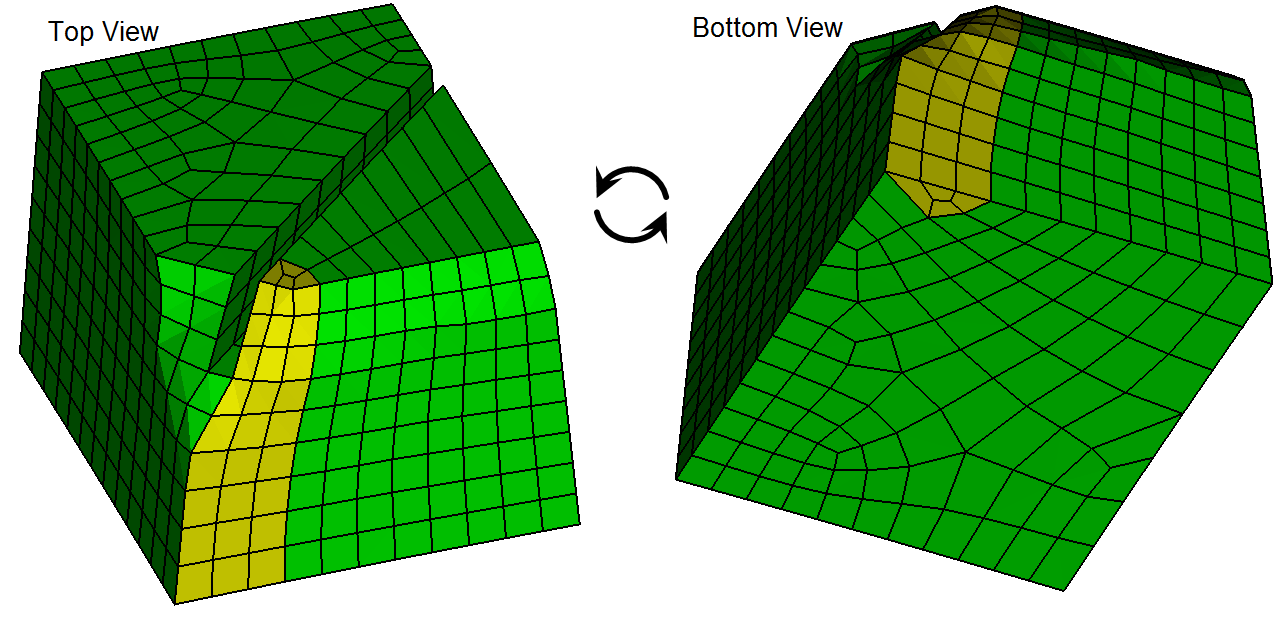

Hexahedral mesh cleanup is newer to Coreform Cubit and currently only a single type of bad element is found and fixed. The hex mesh quality configuration that is currently implemented is when a column of hex elements is on the boundary of a volume, the hexes in the column each have 2 adjacent quad faces on the boundary, and the dihedral angle between those 2 faces is greater than the specified angle tolerance. This situation is illustrated in Figure 1 where the red column of hexahedra has a good angle on the source surface, which flattens out to 180 degree angle on the target creating inverted hex elements. The angle parameter determines how large the angle can get before being cleaned up.
Figure 1. Example of hexahedral mesh with case handled by hex mesh cleanup.

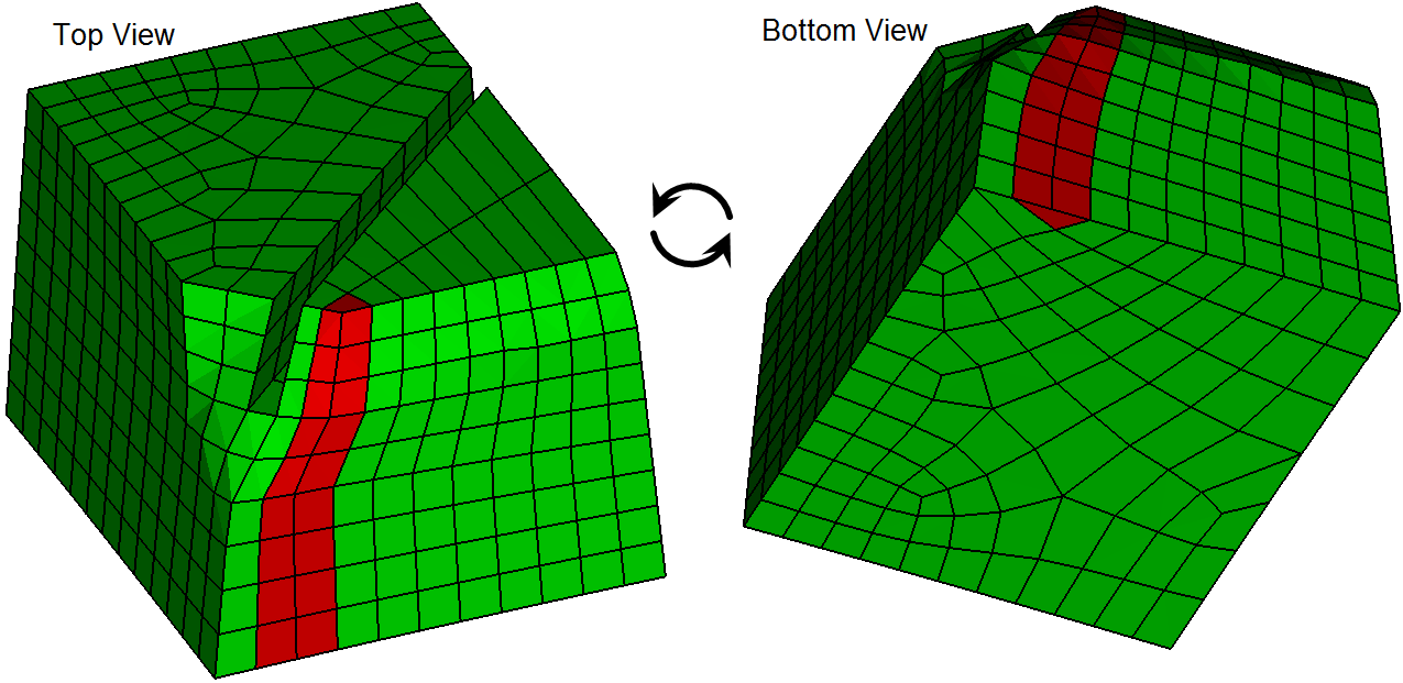

Figure 2 illustrates the result of hex mesh cleanup. Internally, Coreform Cubit finds the column of hexahedra with the bad elements, as well as an adjacent column of hexahedra, and then automatically performs some hex column operations followed by smoothing to improve the quality of the elements locally.
Figure 2. The mesh from Figure 1 after hex mesh cleanup.
