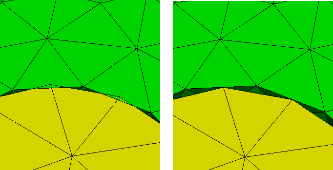

In addition to finding mesh intersection , Coreform Cubit can also remove mesh intersection by slightly repositioning the nodes of intersecting elements. Nodes are moved along surface normals just enough so that the intersection is zero or undetectable. The command syntax is:
Remove Mesh Intersection {Block|Body|Volume} <id_list> [with {Block|Body|Volume} <id_list>] [low <value=0.0001>] [high <value>] [detail]
The low and high options set how much cumulative intersection should be detected. A low value of 0.1 would ignore elements that do not intersect more than 10% of their volume. Similarly, a high value of 0.5 would discard elements that intersect more than 50% of their volume. Both low and high can be used simultaneously. The default for the low value is 0.0001
The detail option provides information, printing the ten nodes moved the largest distances, providing users an idea of the greatest changes in the mesh.

Figure 1. "Before and after mesh intersection removal"
