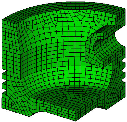

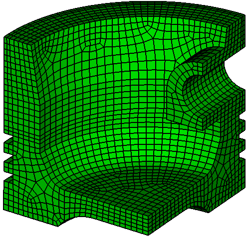

Coreform Cubit supports the scaling of hexahedra and tetrahedra meshes. Mesh Scaling allows a series of meshes to be built [typically] for solution convergence studies or other purposes. Each mesh has progressively larger or smaller elements. For example, if the input mesh has 10,000 hexahedra, scaling with a multiplier of 2.0 will result in a mesh of about 20,000 hexahedra, with approximately the same element orientation and size gradations as the original, as seen in Figure 1. Additional meshes can be built by scaling the original mesh with multipliers of 4, 6, 8, etc. Scaling by a value less than 1.0 will produce a mesh with fewer elements. Scaling by a negative value is not allowed. Convergence studies can be performed with much less computational cost than if traditional global refinement is used, because the element increase at each step of the series can be smaller.
Figure 1.

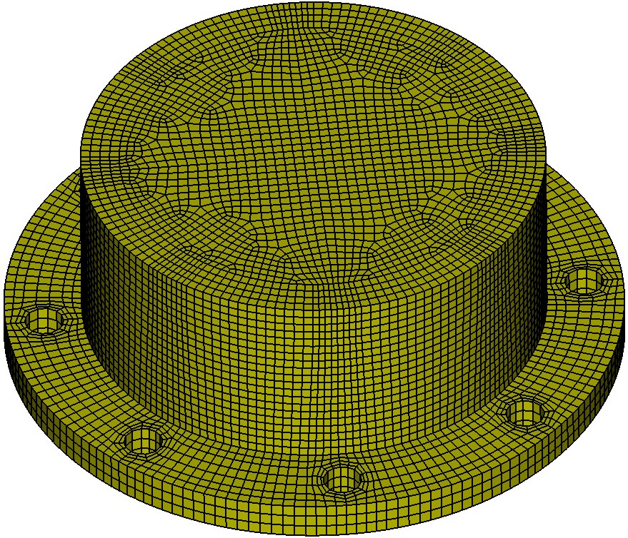

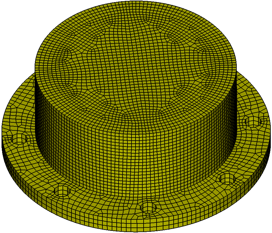

The target number of output elements is the number of input elements times the multiplier parameter. The default value is 2.0. For example: the mesh in Figure 2a has 3025 hex elements. After scaling by 2.0, the mesh in Figure 2b has 6804 hexes. Note the locations of new nodes are projected to lie on the associated CAD geometry, if any.
Figure 2a. Input mesh of 3025 hex elements.
Figure 2b. Output mesh of 6804 hexes,
after scaling with a multiplier of 2.0.

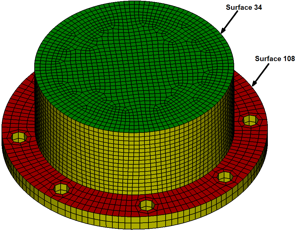

In some cases, the user may want to use swept blocks in only some parts of the model. The original mesh may have small regions with carefully constructed meshes. Using swept_blocks can destroy these constructions, replacing them with pave-and-sweep meshes. These constructions can be preserved by specifying force_structured for the surfaces and volumes containing them.
For example, see Figures 3, 4 and 5. In Figure 3 surface 108 was meshed with great care to ensure a structured mesh around the holes, while surface 34 was meshed with paving. Since surface 108 has irregular nodes, it appears to Mesh Scaling as the source surface of a swept block. Figure 4 illustrates the resulting mesh from the command "scale mesh multi 2". Notice the structured meshes around the holes have been replaced with a standard paved mesh. Figure 5 illustrates preserving the structured holes of surface 108 while allowing surface 34 to be repaved. The command was "scale mesh multi 2 force_structured in surface 108". A different mesh would result from the command scale mesh multi 2 force_structured in volume 1 , because this would also preserve the irregular nodes in surface 34, resulting in more blocks and a less smooth mesh.
Figure 3. Input mesh. Surface 108's mesh has desired structure and irregular nodes. Surface 34 contains a paved mesh.
Figure 4. Output mesh from the command "Scale Mesh Multi 2". The mesh on surface 108 is replaced with a paved mesh.
Figure 5. Output mesh from the command "Scale Mesh Multi 2 force_structured in Surface 108". The desired features are maintained, while swept blocks are used in unimportant regions.
