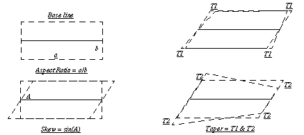

Details on Robinson Metrics for Quadrilaterals
The quadrilateral element quality metrics that are calculated are aspect ratio, skew, taper, element area, and stretch. The calculations are based on metrics described in (Robinson, 87). An illustration of the shape parameters is shown in Figure 1, below. The stretch metric is calculated by dividing the length of the shortest element edge divided by the length of the longest element diagonal.
Figure 1. Illustration of Quadrilateral Shape Parameters (Quality Metrics)
