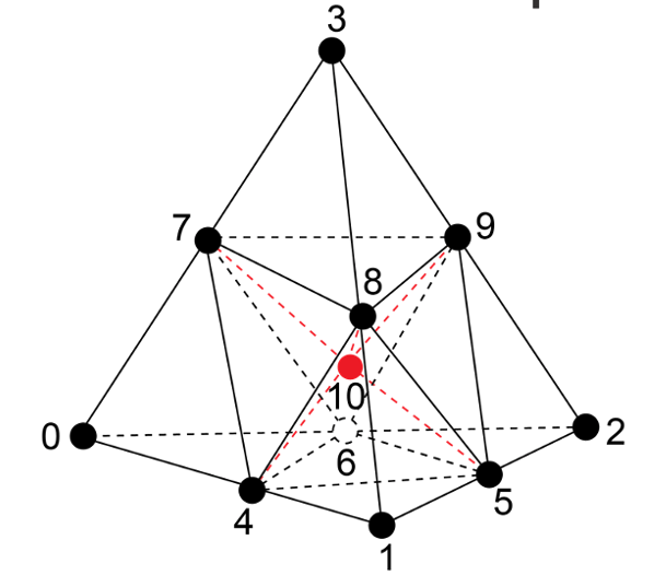

Normalized Inradius: Ratio of minimum subtet inner radius to tet outer radius (circumsphere). Subtets are defined by subdividing the tet into 12 smaller tets by using a common point at the centroid of the tet and the 6 mid-edge nodes as shown in Figure 1. The minimum in-radius of any of these 12 tets normalized by its parent outer-radius and a constant is used to determine this metric. The Normalized Inradius metric is also valid for linear elements, except that all mid-edge nodes are defined as the midpoint of their corner nodes.
Figure 1. Subtet subdivision used for determining Normalized Inradius quality metric
Mean Ratio: General description: Mean ratio quality metric measures the deviation of a tetrahedral element from an equilateral tetrahedron through the root-mean-squared edge length. In this context, we employ a volume ratio. For a 4-node tet, the volume is compared to the cube of root-mean-squared length of the six edges. For the 10-node tet, 12 sub-tets are formed and minimum mean ratio of the 12 is returned. Unlike the normalized inradius, the mean ratio is quite sensitive to a single, highly-elongated sub-tet. We note that for an equilateral 10-node tetrahedral element, there are two families of sub-tetrahedra. Sub-tets connected to the corner nodes or parent nodes of the 4-node tet have a mean ratio of 1 by construction. They are equilateral tets. The other family of sub-tets are not equilateral tets. These interior sub-tets connected entirely to mid-edge nodes are scaled such that all sub-tetrahedra have a mean ratio of 1 for an equilateral tet.
