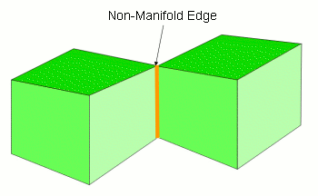

For hexes and tets it looks for edges with two or more elements connected that do not share common faces.
Figure 2. Topology check for hexes and tets
