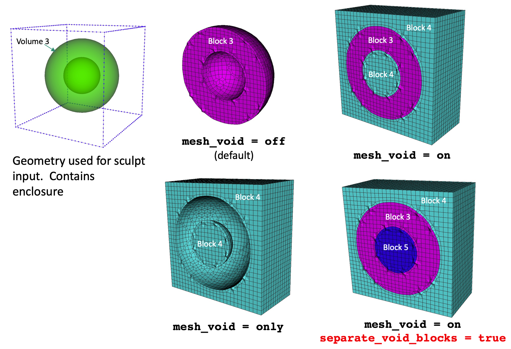

Separate Void Blocks
Command: separate_void_blocks     Separate void into unique block IDs
Input file command:   separate_void_blocks
Command line options: -SVB
Command Description:
When the mesh_void option is used, the default case will generate a single block ID for all elements in the void region. Turning this option ON will separate the elements into unique block IDs where the elements are contiguous. For example, elements in a void region completely enclosed and interior to a volume will be assigned a different block ID to those exterior to the volume. The void_mat option can be used to specify the ID of the first void block. Subsequent blocks will be numbered incrementally from the first void mat ID. If void_mat is not defined, the next highest IDs not used by a material will be used for the void block IDs.
Example of the effect of using separate_void_blocks with the mesh_void option

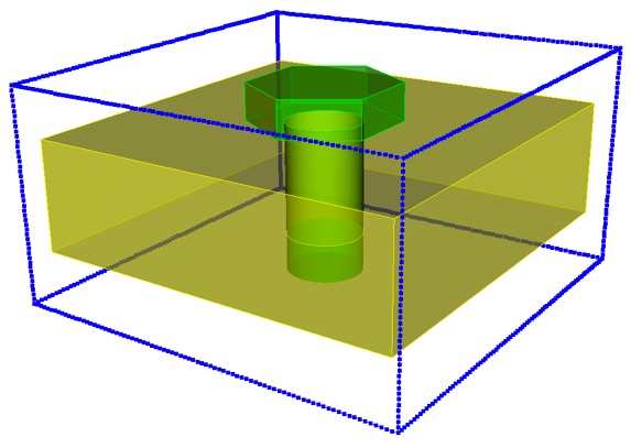

Geometry used in sideset examples below.
Generate exodus sidesets using one of the following options:

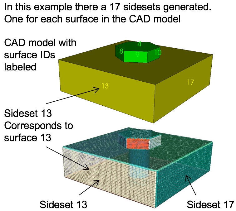

geometric_surfaces (3): Sidesets will be generated according to imported surface ID information. STL files may include an optional surface designation for any or all triangles in the file. Surface information may be written automatically from Cubit based on geometric surface IDs or sideset IDs. See the Cubit sculpt parallel sideset option for more details. Alternatively, use the "export stl ..." command with the "sidesets" option to export all sidesets in a Cubit model as surface information. If present, one sideset will be generated for each surface designation in the STL file. Following is an example surface designation in an STL file. It would appear following all triangles.
        surface 1
          0 1 2 3 4 5 6 7 8 9
          10 11 12 13 14 15 16 17 18 19
          20 21 22 23
        endsurface 1
The id following the surface designation will be used as the sideset ID. Up to 10 triangle IDs, per line may be assigned to the surface. Triangle IDs are assigned based on order they appear in the STL file. Any number of surfaces may be defined. For this option, the assumption is that all triangles included in the STL files will be included in at least one surface designation.
gen_sidesets3
Example of all geometric surfaces (3) defining sidesets.

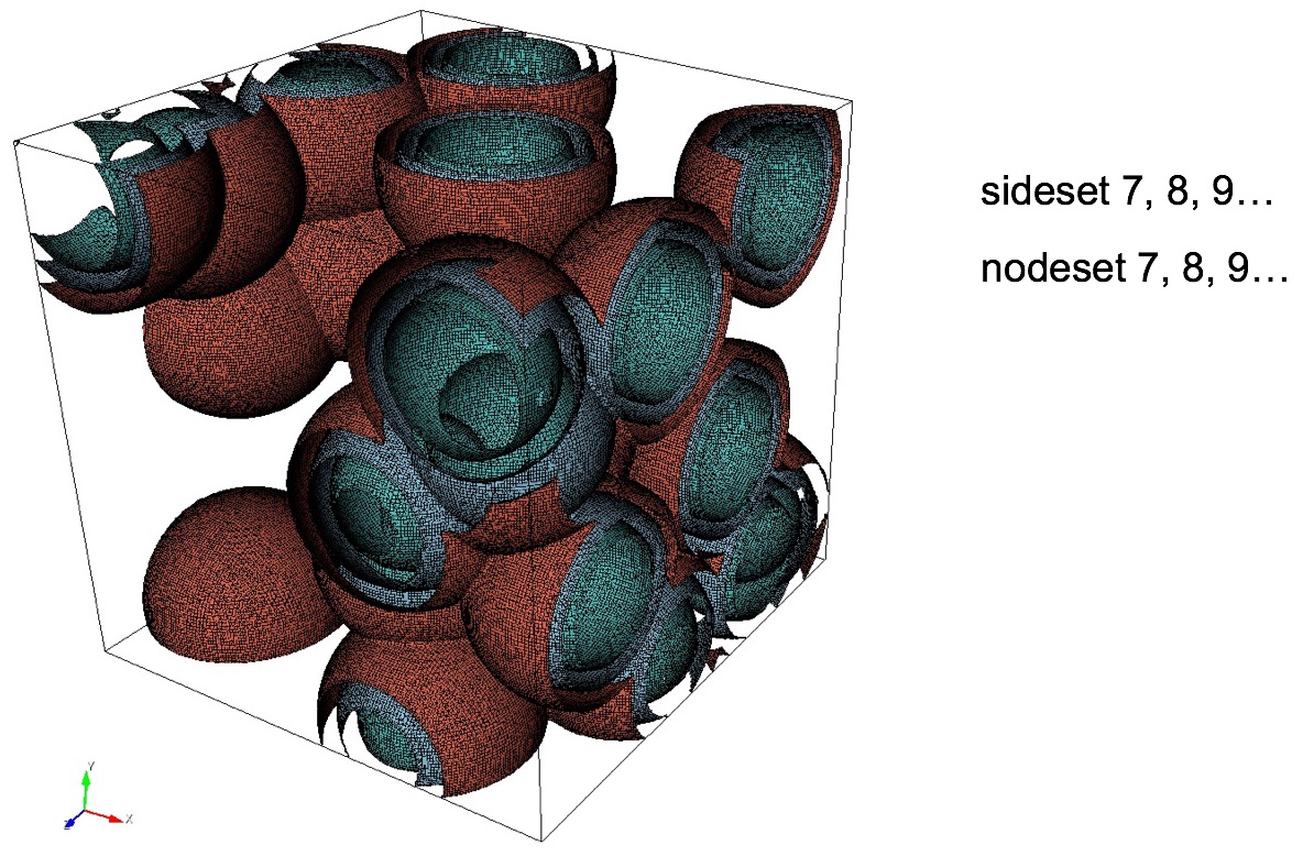

RVE (5): When using the full bounding box, such as representative volume elements (RVE) for microstructures, the nodesets and sidesets with IDs 1 to 6 are reserved for the six faces of the bounding box. They are assigned as follows:
        Nodeset/Sideset ID      Contains nodes/faces
               1                on minimum X domain boundary
               2                on maximum X domain boundary
               3                on minimum Y domain boundary
               4                on maximum Y domain boundary
               5                on minimum Z domain boundary
               6                on maximum Z domain boundary
In addition, a nodeset and sideset will be generated on interior surfaces for each unique pair of adjacent material IDs. One final nodeset will also be generated along interior curves at all internal triple junctions (curves where at least 3 surfaces share a common curve).
gen_sidesets5-1 gen_sidesets5-2
Example of automatically defined sidesets at domain boundaries of an RVE and at all interface surfaces between materials.

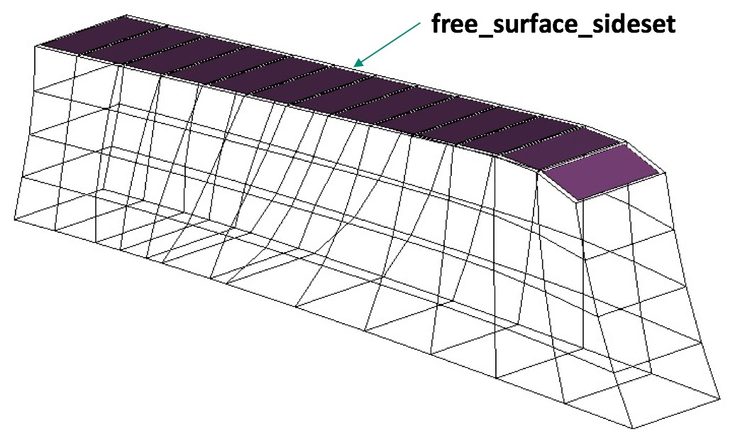

Given exodus sidesets are treated as interior surfaces for STL projection.
Used with the input_mesh option when using an exodus mesh as the base grid. This may be useful if the capture option is enabled and some of the STL surfaces are close in proximity to the boundaries of the input exodus mesh. When close in proximity, sculpt will by default not project those boundary nodes to the STL surface but keep them on the domain boundary. If a list of sideset IDs are given here, the sideset faces will be projected to the STL. The sideset IDs should refer to sidesets that are defined in the specified input_mesh exodus file.
sculpt_free_surface_sideset
Example of free_surface_sideset defined on the top surface faces of an input mesh

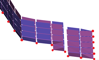

If used with an unstructured base grid (input mesh), this option allows the user to define a crack in the input mesh, where the faces of each vertical side (wall) of the crack are each in a different sideset. The faces at the bottom of the crack share a common edge (V-bottom) or face (square-bottom). Sculpt will match or equalize the volume fractions of the bottom cells on either side of the crack. This produces a uniform, higher quality mesh at the crack. The sidesets must be specified in a pairwise order. This option must be used with the --input_mesh (-im) option.
