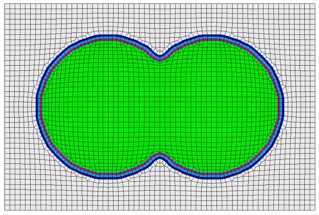

Sculpt options for defining boundary layers in the mesh. Boundary layers are thin hex layers that can be defined at surfaces, extending either inward or outward from a material. The user may specify the number and thickness of the hex layers as well as the material ID of the layers. Layer thicknesses should normally be "thin" with respect to the size of the cells. Layers will not intersect, so should be defined on surfaces where nearby layers will not overlap. Boundary layers are specified based upon a material ID, where hex layers will be placed at surfaces where the material interfaces with other materials, or at free surfaces.
boundary_layer1
Example of boundary layers.
boundary_layer2
Boundary layers defined at the surfaces of a material.

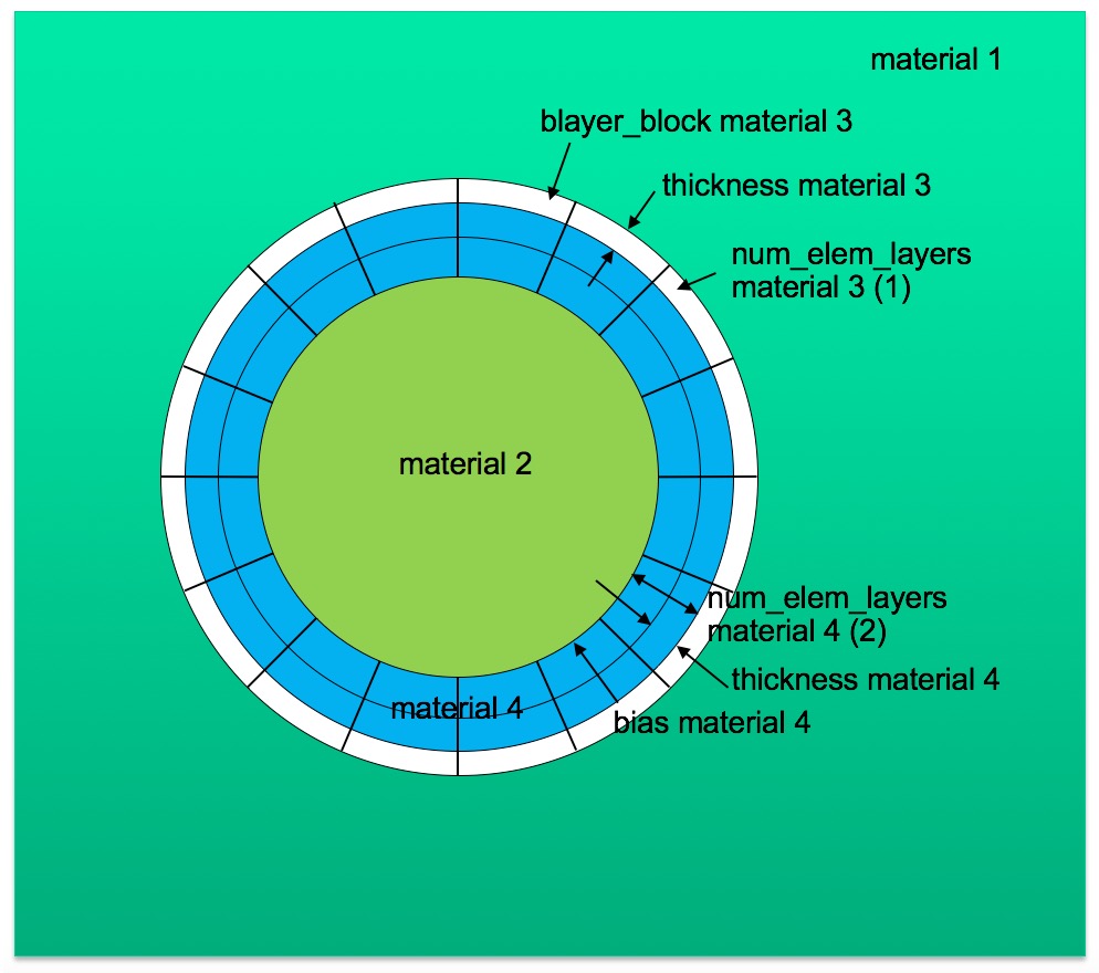

Example:
The following example shows a boundary layer specification in a sculpt input file. In this example, two boundary layer blocks are defined at the interface of materials 1 and 2. Two material blocks with ID 3 and 4 are generated with 1 and 2 element layers respectively.
       BEGIN BLAYER
         MATERIAL = 1 2
         BEGIN BLAYER_BLOCK
           MATERIAL = 3
           NUM_ELEM_LAYERS = 1
           THICKNESS = 0.1
         END BLAYER_BLOCK
         BEGIN BLAYER_BLOCK
           MATERIAL = 4
           NUM_ELEM_LAYERS = 2
           THICKNESS = 0.2
           BIAS = 1.3
         END BLAYER_BLOCK
       END BLAYER
boundary_layer3
Example schema for boundary layers corresponding to input file below.
