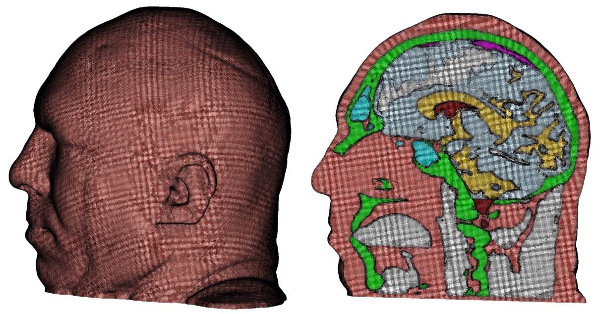

Bitmap Files
The Diatom format will also support bitmap files. These are binary files that set each cell either on or off for the specified material. The following is an example diatom specification for a bitmap file. Note that the bitmap specification includes nx, ny, nz dimensions for the size of the input file.
    diatoms
      package 'Skull'
        material 1
        insert bitmap
          file = 'skull_bitmap_file'
          nx = 680
          ny = 408
          nz = 236
        endinsert
      endpackage
    enddiatom
bitmap_input
Example mesh generated with Diatom bitmap option
For a full description of the diatom format see the CTH or Alegra documentation.

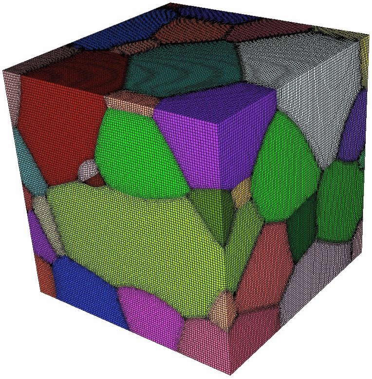

Input Microstructure File
Command: input_micro     Input from Microstructure file
Input file command:   input_micro <arg>
Command line options: -ims <arg>
Argument Type:        file name with path
Command Description:
microstructure
Example all-hex mesh of microstructure
A microstructure file is an ascii text file containing volume fraction data for each cell of a Cartesian grid. The format for this file includes header information followed by data for each cell. The following is an example:
TITLE = triple line system
VARIABLES = x y z, phi_1, phi_2, phi_3
ZONE i = 2 , j = 2 , k = 2
0.0000       0.0000       0.0000      0.5000      0.5000      0.0000
1.0000       0.0000       0.0000      0.3333      0.3333      0.3334
0.0000       1.0000       0.0000      1.0000      0.0000      0.0000
1.0000       1.0000       0.0000      0.0000      1.0000      0.0000
0.0000       0.0000       1.0000      0.2000      0.4000      0.4000
1.0000       0.0000       1.0000      0.6000      0.1000      0.3000
0.0000       1.0000       1.0000      0.0000      0.0000      1.0000
1.0000       1.0000       1.0000      0.9000      0.0000      0.1000
The header information should contain the following:
TITLE: any descriptive character string
VARIABLES: a list of variables separated by spaces or commas. It should include x, y, z as the first three variable names. The remaining names are arbitrary. The number of variable names listed must correspond to the number of data values for each cell of the Cartesian grid.
ZONE: Specify the number of cells in the i, j and k directions (corresponding to x, y, and z respectively)
The body of the file will contain one line per cell of the grid. The first three values correspond to the centroid location of a cell in the grid. The remaining values represent volume fractions for the cell for each variable listed. The sum of the volume fractions for each individual cell should be 1.0
Currently this format assumes that cell sizes are exactly 1.0 x 1.0 x 1.0 and the minimum cell centroid location is always 0.0, 0.0, 0.0. This results in a Cartesian grid with minimum coordinate = (-0.5, -0.5, -0.5) and maximum coordinate = (i-0.5, j-0.5, k-0.5). If a size other than 1x1x1 is required consider using the scale and/or translate options.
Example usage of this command is as follows:
  sculpt -j 8 -ims my_micro_file.tec -p 1
Smoothing: Sculpt will set automatic defaults for smoothing if user options have not been defined. These include:
--smooth 9 (surface smoothing option - no surface projection)
--csmooth 2 (curve smoothing option - hermite interpolation)
These options will generally provide a smoother curve and surface representation but may not adhere strictly to the volume fraction geometric definition. To over-ride the defaults, consider using the following options:
--smooth 8 (surface smoothing option - projection to interpolated surface)
--csmooth 5 (curve smoothing option - projection to interpolated curve)
Pillowing: For most 3D models it is recommended using pillowing since triple junctions (curves with at least 3 adjacent materials) will typically be defined where malformed hex elements would otherwise be generated. Surface pillowing (option 1) is usually sufficient to remove poor quality elements at triple junctions.
micro-pillow
Pillows (hex layers) inserted at surfaces to improve element quality around curves. Note mesh quality at curve between surfaces A and B.

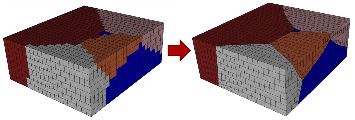

Input Cartesian Exodus File
Command: input_cart_exo     Input from Cartesian Exodus file
Input file command:   input_cart_exo <arg>
Command line options: -ice <arg>
An exodus mesh containing a Cartesian grid of elements can also be used as the source of a sculpt mesh. For this option the following conditions must be met:
input_cart_exo
Example Cartesian Exodus file and the resulting hex mesh.
  1. A single (non-parallel) exodus II format file.
  2. Contains only hex elements configured as a Cartesian grid.
  3. All hex elements must be exactly equilateral cubes.
  4. Each hex element has been assigned to exactly one block. (Any number of blocks may be defined in the file)
Provided these conditions are met, sculpt will treat each block as a separate material and generate a smooth conforming mesh between the materials. This option is useful for converting a stair-step mesh into a smooth conforming mesh. The resulting sculpt mesh will have the same dimensions as the original exodus mesh, but will add layers of hexes at material interfaces.
  sculpt -j 8 -ice my_cartesian_file.e -p 1

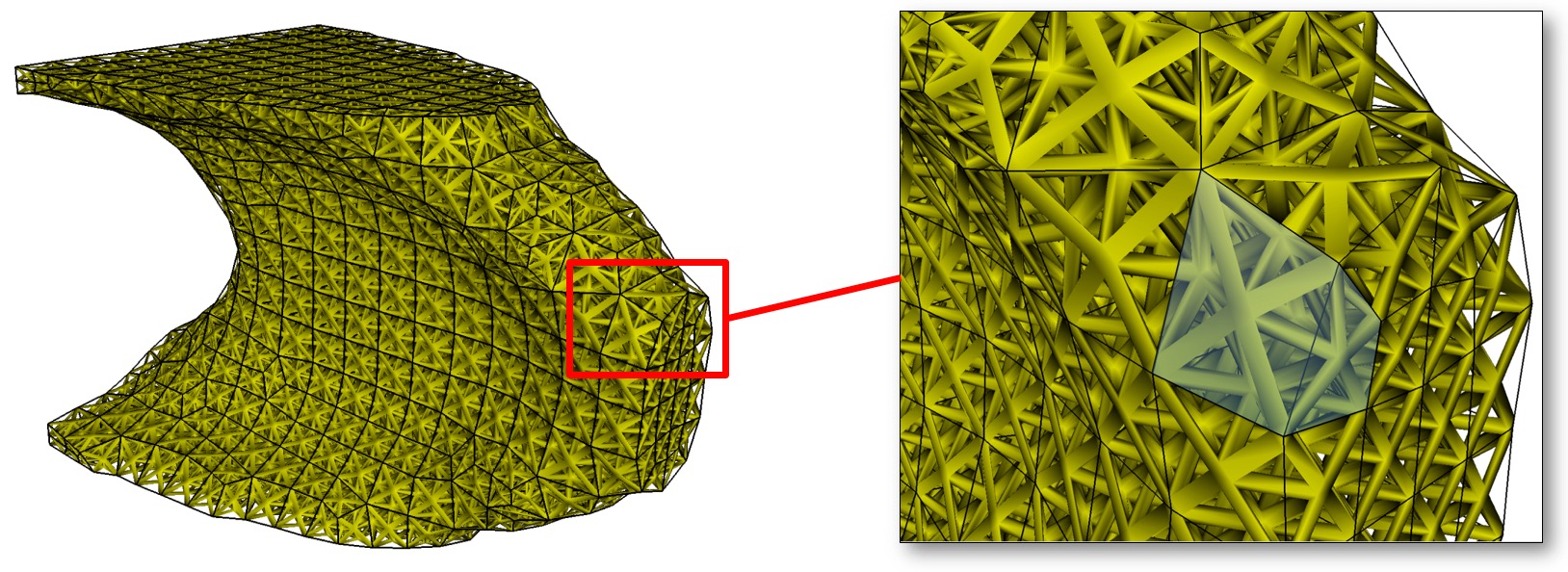

lattice
Lattice geometry generated from exodus mesh.
Generate a lattice structure from a hex mesh. This command takes the name of an STL format template file which defines the lattice over a unit cube. To generate a valid lattice structure, the facets should be symmetric to the three coordinate planes. The lattice structure will be transformed and copied into each hex of the mesh. The result will be an STL file containing lattice geometry for the mesh.
This option currently requires the name of an exodus mesh on which to define the lattice. Use the --exodus_file (-e) option to specify its path. The current implementation is limited to one block, however if a second block is contained in the Exodus file it will be treated as a solid and stl facets will be generated at the skin of the block.
The name of the output STL file may also be defined by using the --stl_file (-stl) option. If no stl file is specified, the output will use the name of the input exodus file with the extension "_lattice.stl" appended.
In addition to the full lattice geometry, an additional file containing only the lattice from the first layer of hexes will be written. This may be useful in reducing the size of the STL file for visualization purposes only. The name of this file will be the name of the full STL geometry file with the extension ".vis.stl" appended.
The following is an example input file using the lattice option:
  BEGIN SCULPT
    lattice = lattice_template.stl  $contains unit cube with triangles
    exodus_file = file.e $ hex mesh containing one or two element blocks
    stl_file = file.stl $ name of output stl file
  END SCULPT
Note that this option is currently limited to serial execution (-j 1)
