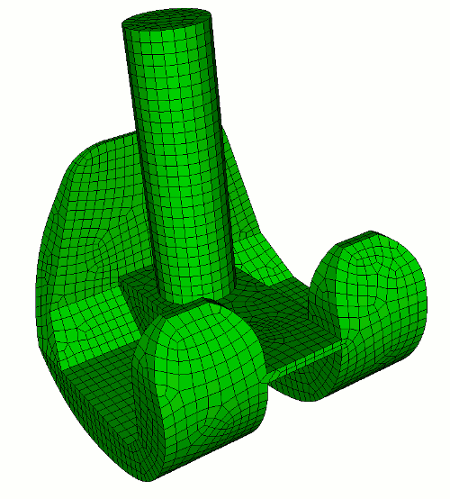

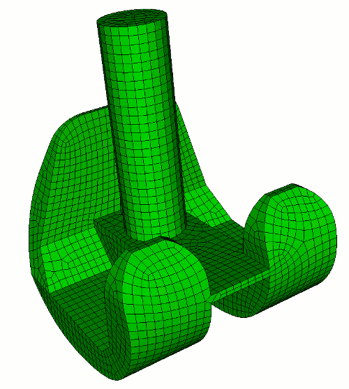

The extend option attempts to group several defective nodes in a region that may be replaced with a template that has fewer defects. The images below show a mesh before and after using this option.
Figure 2. Paved mesh before using cleanup extend
Figure 3. Paved mesh after using cleanup extend
