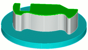

Figure 1. Exterior view

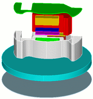

Figure 2. Interior view
We examine several of the volumes below.

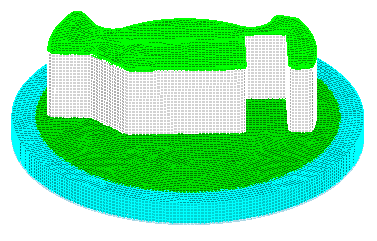

Final mesh
The final mesh is created at a size of 0.15 for all volumes.
