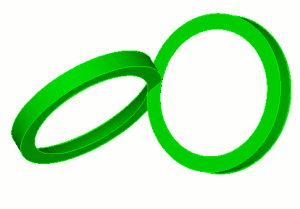

The following example is composed of two rings of constant cross-section that can be swept along their axes. The problem here is that the rings overlap, forming a tetrahedral shape which cannot be swept. The key to solving this problem is separating out the region of overlap, explicitly setting the source and target surfaces, and using the tetprimitive scheme on the tetrahedral region.

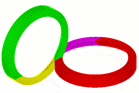

There are five volumes that result from the webcutting. Two of them are automatically sweepable. Two of them must have their schemes set explicitly, and one of them is meshed using the tetprimitive scheme.
Webcut Command
One-to-one Sweepable
Source and target are set automatically using autoscheme
Coreform Cubit> volume 1 3 scheme auto
Must have source and target set explicitly
Coreform Cubit> volume 2 scheme sweep source 17 target 7
Coreform Cubit> volume 4 scheme sweep source 29 target 18
Non-sweepable
Use the tetprimitive scheme
Coreform Cubit> curve in volume 5 interval 6
Coreform Cubit> volume 5 scheme tetprimitive
Coreform Cubit> volume all size 0.5
Coreform Cubit> mesh volume all
Final mesh
The final mesh is created at a size of 0.5 for all volumes.
