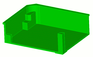

Example 3. Webcutting using the sweep option
This example introduces additional webcutting options. This example would be a simple many-to-one sweep except for the overhanging lip and the protrusions on the bottom surface. To a beginner user, it may at first seem reasonable to use the bottom surface as a webcutting plane. However, this will not create a many-to-one sweepable volume. Instead, you need to use the protruding surfaces as cutting planes, and extend them through the entire volume.
Suggested webcuts
Webcut Command
Coreform Cubit> webcut volume 1 with sheet extended from surface 27
Coreform Cubit> webcut volume 1 with plane surface 30

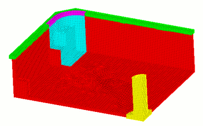

Coreform Cubit> webcut vol all sweep surf 26 vector -1 0 0 through_all
Now Volume 3 (red) has only 1 target surface.
Coreform Cubit> imprint all
Coreform Cubit> merge all
Coreform Cubit> volume all size 0.05
Coreform Cubit> mesh volume all
Final mesh
The final mesh is created at a size of 0.05 for all volumes.
