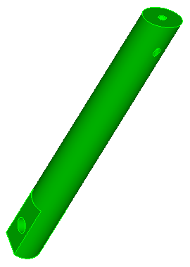

One technique for creating a symmetric mesh on a symmetric model is to mesh only half of the volume, then copy the mesh onto the other half. The following example employs this technique. This model at first appears quite simple, but it actually requires a good deal of webcutting to get a reasonable mesh that is not highly skewed.

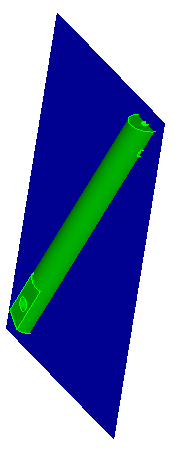

Coreform Cubit> webcut body 1 with plane xplane offset 0 Coreform Cubit> delete body 2 |

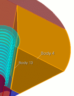

Coreform Cubit> unite body 4 13 Coreform Cubit> delete vertex all Coreform Cubit> imprint all Coreform Cubit> merge all Coreform Cubit> vol all size .5 |

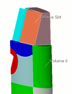

Coreform Cubit> webcut body 18 with plane surface 540 |
Coreform Cubit> webcut volume 9 with plane zplane offset -3 rotate 5 about x This is another effort to prevent skew in the final mesh Coreform Cubit> imprint all Coreform Cubit> merge all |

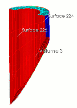

Coreform Cubit> volume 3 scheme sweep source 224 target 226 Coreform Cubit> surf 224 226 scheme map Coreform Cubit> mesh volume 3 |

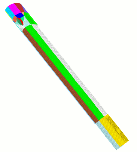

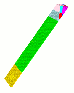

Coreform Cubit> unmerge all Coreform Cubit> body all copy reflect x Coreform Cubit> merge all |
The entire mesh is copied and reflected around the x axis during the last step. The advantage of symmetry in this example is that it cuts the decomposition in half, and it also ensures a perfectly symmetrical mesh.
