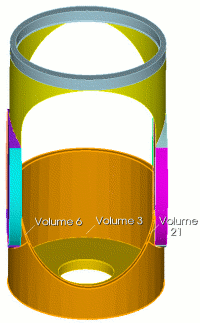

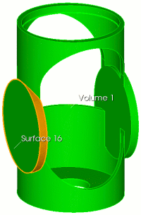

Narrow angles are a challenge for sweeping algorithms. In the next example, a well-placed webcut shaves off the end of the small angle to create an additional surface for the sweeping algorithm.
Webcut | Command |
Coreform Cubit> webcut volume 1 with sheet extended from surface 16 |
Coreform Cubit> webcut volume 5 with plane surface 50 |
Coreform Cubit> webcut volume 4 with plane surface 47 |
Coreform Cubit> webcut volume 3 with sheet extended from surface 36 |
Coreform Cubit> webcut volume 2 with plane surface 25 |
Coreform Cubit> unite volume 3 9 7 |

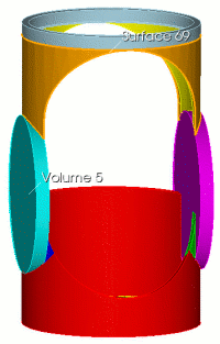

Coreform Cubit> webcut volume 5 with sheet extended from surface 13 |
Coreform Cubit> webcut volume 5 with sheet extended from surface 69 |
Coreform Cubit> webcut volume 4 with sheet extended from surface 13 |
Coreform Cubit> webcut volume 4 with sheet extended from surface 69 |

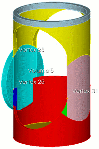

Coreform Cubit> webcut volume 5 with plane vertex 23 vertex 25 vertex 31 |
Coreform Cubit> webcut volume 4 with plane vertex 23 vertex 25 vertex 31 |
Coreform Cubit> webcut volume 16 with plane vertex 18 vertex 9 vertex 33 |
Coreform Cubit> webcut volume 17 with plane vertex 18 vertex 9 vertex 33 |

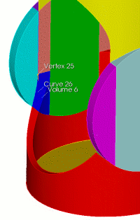

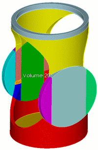

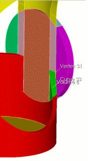

Coreform Cubit> webcut volume 6 with plane normal to curve 26 distance 0.6 from vertex 25 |
Coreform Cubit> delete volume 20 |
Coreform Cubit> webcut volume 8 with plane normal to curve 33 distance 0.6 from vertex 31 |
Coreform Cubit> delete volume 8 |
Coreform Cubit> unite volume 3 21 6 Coreform Cubit> imprint volume all

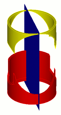

Coreform Cubit> webcut volume 2 3 with plane zplane |
Coreform Cubit> webcut volume 3 with sheet extended from surface 154 |
Coreform Cubit> webcut volume 23 with sheet extended from surface 153 |
Coreform Cubit> webcut volume 11 with plane zplane noimprint nomerge Coreform Cubit> imprint volume all Coreform Cubit> merge volume all |

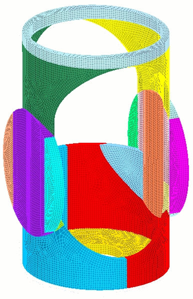

Coreform Cubit> volume 23 sweep smooth auto Coreform Cubit> volume all scheme auto Coreform Cubit> volume all size 0.2 Coreform Cubit> mesh volume all |
The final mesh is shown below.
