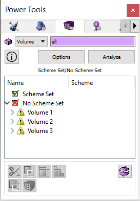

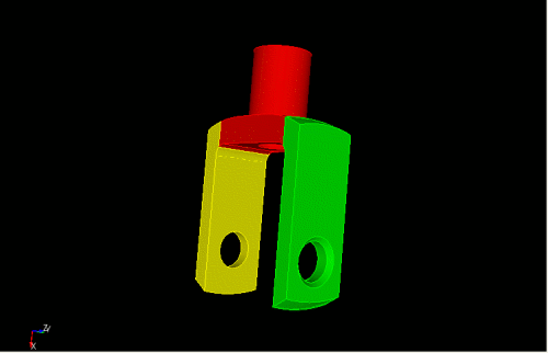

No volumes are listed as automatically meshable. In the graphics window, red indicates that the volume scheme has not been set. Green indicates that the scheme has been set.

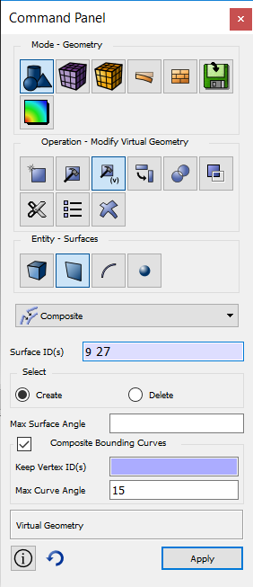

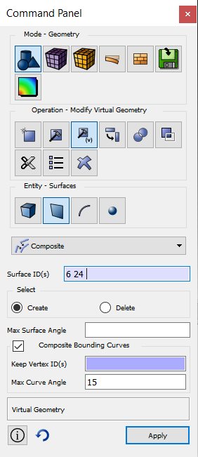

The Geometry-Surface-Modify-Composite menu will open on the Control Panel.

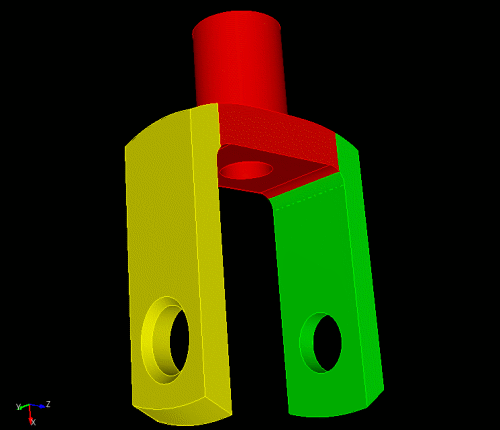

The two surfaces should appear merged.

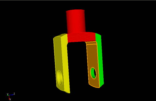

Repeat these steps with the opposite side.

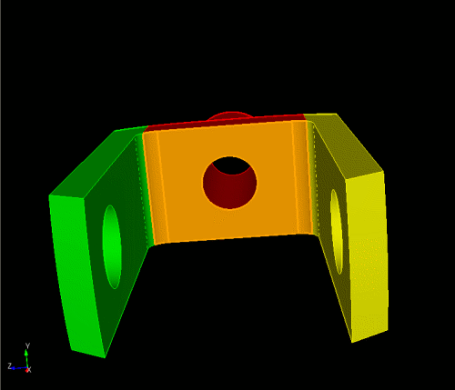

Check to see that the surfaces have been composited and that your graphics window looks like the following image.

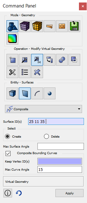

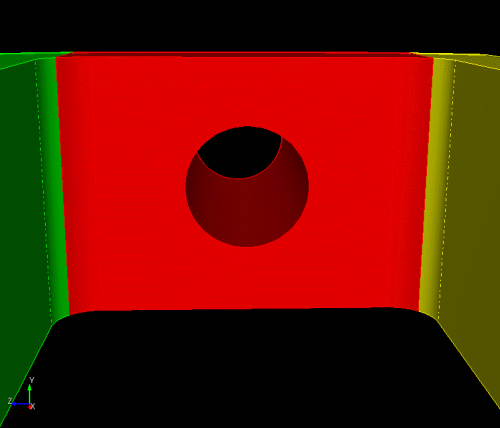

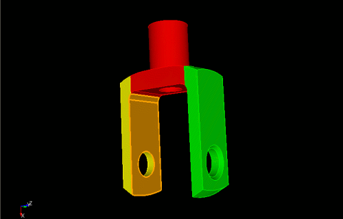

Finally, surfaces 11, 25, and 35 (shown below) need to be composited.
Use the command panel to choose surfaces for the composite command.
Press the apply button and check the results in the graphics window.
