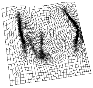

The Super sizing function computes both the Curvature and the Linear function and takes the smaller value of the two. This is an alpha feature and should be used with caution. The following is an example of Super element sizing.
Figure 1. NURBS mesh with super sizing function, 34 by 16 density
