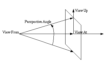

One way to change what is visible in the graphics window is to manipulate the camera used to generate the scene. A scene camera has attributes described below, and depicted graphically in Figure 1. The values of these camera attributes determine how the scene appears in the graphics window.
These view settings may be accessed in the GUI via the Display/View Point menu.
Position (From) - The location of the camera in model coordinates.
View Direction (At) - The focal point of the camera in model coordinates.
Up Direction (Up) - The point indicating the direction to which the top of the camera is pointing. The Up point determines how the camera is rotated about its line of sight.
Projection - Determines how the three-dimensional model is mapped to the two-dimensional graphics window.
Perspective Angle - Twice the angle between the line of sight and the edge of the visible portion of the scene.
Figure 1: Schematic of From, At, Up, and Perspective Angle
