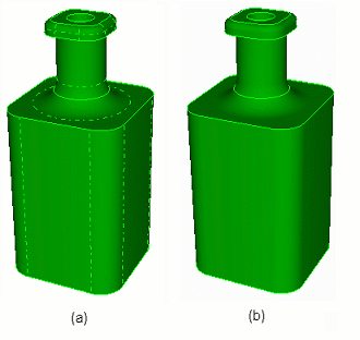

Displaying Composite Surface Lines
Composite surfaces are surfaces that have been joined together using virtual geometry. By default, the underlying surfaces are marked with dashed lines. To toggle this setting so that underlying surfaces are not shown, use the following command:
Graphics Composite {On|Off}
Figure 2. A part shown with (a) composite surfaces displayed (b) composite surfaces not displayed
