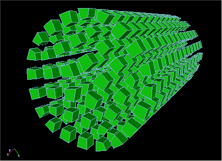

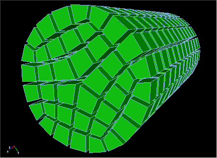

Shrink
The shrink graphics attribute allows you to view the elements shrunken about their centroid. This is useful for viewing 3D meshes, permitting viewing of interior elements. It may also be useful for visually inspecting the mesh for missing elements. To use the shrink option use:
graphics shrink <value>
draw hex <range>
draw tet <range>
etc...
where value is a number between 0 and 1. One (1) will shrink the elements to a point, while zero (0) will not shrink the elements. The following figures illustrate the effect of element shrink on a hex mesh.
Figure 1. Top: shrink=0.2, Bottom: shrink=0.5
