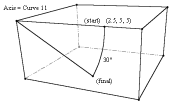

Swing [All] [About] Axis {options} Angle <ang>
Any location can be "swung" (rotated) about an axis by a certain angle. (See the section on specifying an axis for the axis syntax). As with moves, multiple swings can be strung together. The following example rotates the location (2.5, 5, 5) thirty degrees about an axis defined by Curve 11. Note that the right-hand rule is used to determine the direction of the swing about the axis.
draw location 2.5 5 5 swing about axis curve 11 angle 30
Figure 1 - Swinging a Location
