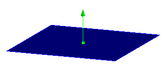

Location and Normal Vector
{Location|Vertex|Node} <origin> Direction <normal>
The first way to specify a plane is to specify a starting point and a direction vector:
draw plane location 1 2 3 direction 0 1 1
draw plane vertex 1 direction
tangent at curve 1
Figure 1. Specifying a plane with a location and surface normal

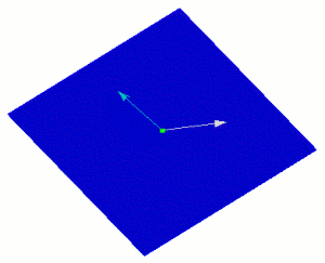

Location and Two Vectors on the Plane
{Location|Vertex|Node} <origin> Direction <vec on plane> Direction <vec on plane>
It is also possible to select an origin point and 2 direction vectors on the plane.
Figure 2. Specifying a plane with a point and 2 in-plane vectors

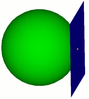

Plane defined by a Surface
Surface <id> [At Location <loc>]
The surface option uses and existing surface to define the plane. If it is not a planar surface, the optional location specifier can be used to find the tangent plane of a specific point on the surface.
draw plane surface 1 at location 4 0 0
Figure 5. Specifying a Tangent plane to a Surface

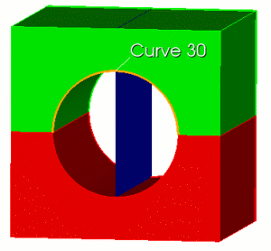

Plane Normal to a Curve
[Normal To] Curve <id> [loc on curve options]
The Normal to Curve option allows you to define a plane by using an existing curve. The direction of the curve will define the surface normal of the new plane. The optional location argument specifies which point to use on the curve if it is not a straight curve. If no location is specified the plane will originate at the midpoint of the curve. See Specifying a Location on a Curve for more information on location options.
brick x 10
cylinder radius 3 z 12
subtract body 2 from 1
webcut body 1 xplane
draw plane normal to curve 30
Figure 6. Draw Plane Normal to Curve
