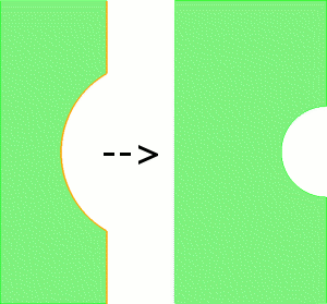

Removing a Curve
Tweak Curve <id_list> Remove [Keep] [Preview]
Similar to the Tweak Curve Remove command, the tweak curve remove function removes a specified curve from a sheet body. Figure 4 shows a simple example of removing a curve from a sheet body.
Figure 4. Removing a curve from a sheet body
The keep option prevents the destruction of the original geometry after the operation. The preview option temporarily displays the new geometry configuration without actually changing the geometry.

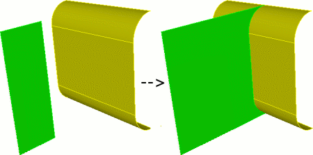

Use Tweak Curve Target to offset a curve to a specified surface, plane or curve. Figure 5 shows an example of tweaking a curve to several surfaces.
Figure 5 Tweaking a curve to multiple target surfaces

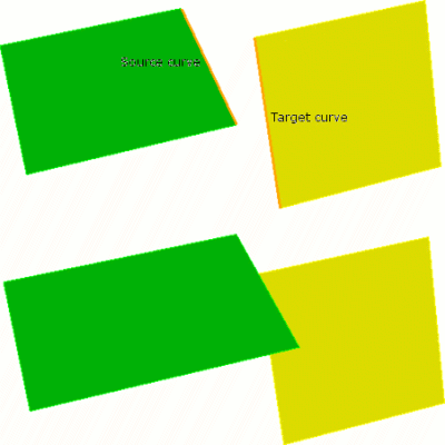

Although it may not be intuitive curves can also serve as the target geometry. Figure 6 shows an example of extending a curve to another curve.
Figure 6 Tweaking a curve to a target curve
Notice that the source curve actually extends to the target curve as if the target were a surface.

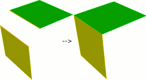

Tweaking a Pair of Curves to a Corner
When creating mid-surface geometry it is often useful to extend surfaces to form a corner. To handle this specific but common case use the tweak corner command.
Tweak Curve <id> <id> Corner [Preview]
Figure 7 shows a typical tweak corner example. Notice that surfaces are extended/trimmed to intersect at a corner.
Figure 7. Tweaking two curves to a corner
