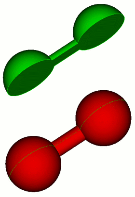

2. Sweep Surface About Axis: Sweeps a surface about a specified vector or axis through a specified angle. The axis of revolution is specified using either a starting point and a vector, or by a coordinate axis. This axis must lie in the plane of the surfaces being swept. The steps parameter defaults to a value of 0 which creates a circular sweep path. If a positive, non-zero value (say, n) is specified, then the sweep path consists of a series of n linear segments, each subtending an angle of [( sweep_angle ) / ( steps-1 )] at the axis of revolution. The include_mesh option will create a volumetric mesh if the surface is already meshed as shown below.  The keep option will keep the original surface while creating the volume.
Sweep Surface {<surface_id_range>} Axis {<xpoint ypoint zpoint xvector yvector zvector>|Xaxis|Yaxis|Zaxis} Angle <degrees> [switchside]  [Steps <number_of_sweep_steps>] [Draft_angle <degrees>] [Draft_type <0|1>][rigid][anchor_entity][include_mesh] [keep] [merge]
Surface swept around an axis of 50 degree angle
Specifying multiple surfaces that belong to the same body will not work as expected, as ACIS performs the sweep operation in place. Hence, if a range of surfaces is provided, they ought to each belong to different bodies.

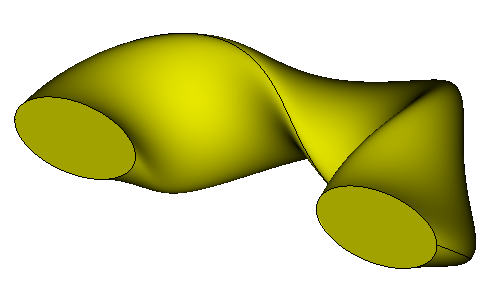

The twist option specifies the number of degrees that a surface should twist along the reference curve during the sweep.
create surface ellipse major radius 2 minor radius 1 zplane surf 1 move x 5 create curve arc radius 5 center location 0 0 0 normal y start angle 0 stop angle 180 sweep surface 1 along curve 2 keep individual twist 360
Volume generated by sweeping a surface along a reference curve with a twist

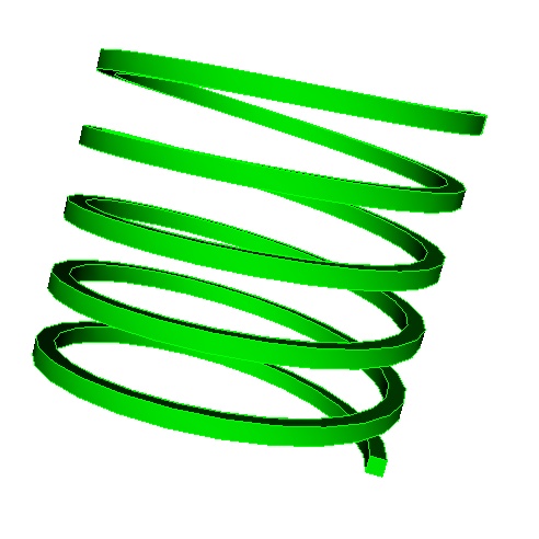

14.  Sweep Surface along Helix: Sweep a surface along a helix, where the helix is defined by an axis, thread_distance (distance between turns in axis direction), axis, and handedness (right_handed or left_handed.
Sweep {Surface|Curve} <id_range> Helix    {axis <xpoint ypoint zpoint xvector yvector zvector>  | xaxis | yaxis | zaxis} thread_distance <val> angle <val>    [RIGHT_HANDED|left_handed] [anchor_entity] [include_mesh] [keep] [merge]
*** Specifying multiple Surfaces that belong to the same Body can cause  the creation of invalid Bodies and is discouraged. ***
axis = axis about which to create the sweep
thread_distance = distance between each 360 degree segment of the helix
angle = number of degrees in rotation of the helix
handedness = right-handed or left- handed threads
Helical Sweep
