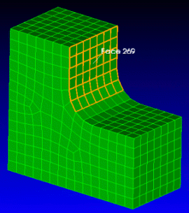

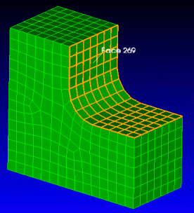

The following figures illustrate the use of the seed method to create mesh groups using the feature angle and divergence methods.
Coreform Cubit> group 'mygroup1' add seed face 269 feature_angle 45
Coreform Cubit> group 'mygroup2' add seed face 269 feature_angle 45 divergence

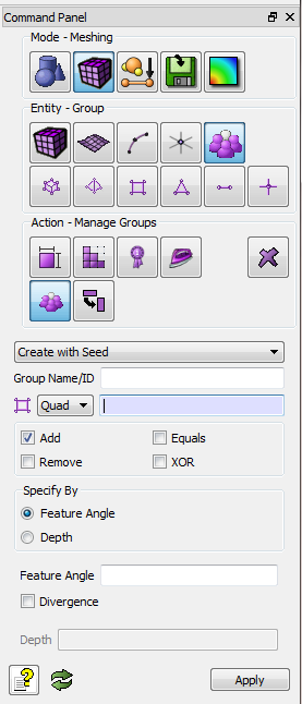

The GUI command panel for this command is found by selecting
"Mode-Meshing", "Entity-Group", "Action-Manage Groups", then "Create with Seed." The command panel is shown below:
