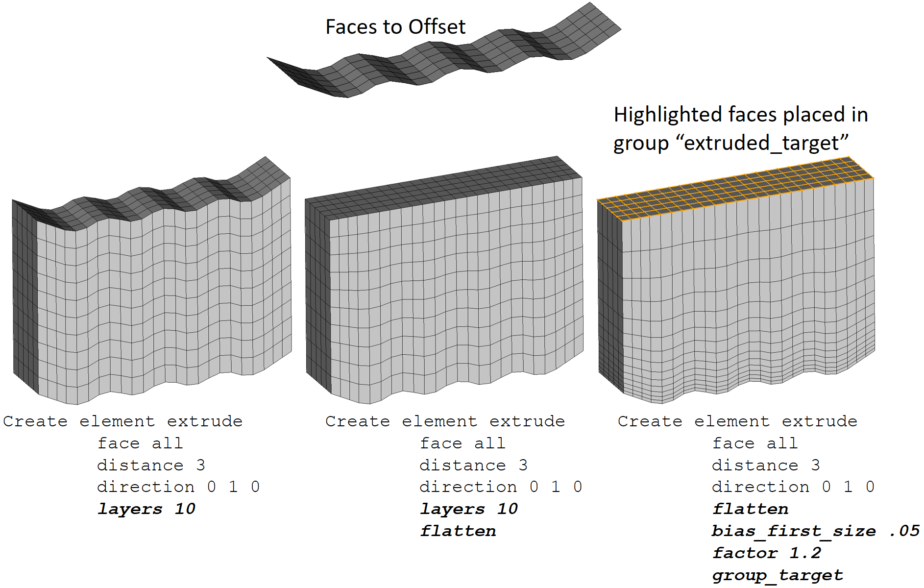

In the first form of the command, a direction and distance are specified to define the extrusion. To define node spacing along the extrusion, the command takes either the layers or bias_first_size and factor parameters, but not both. Specifying a value for the layers option determines how many evenly sized elements will be created in the given distance. The bias_first_size and factor parameters define a bias that will be used along the extrusion distance. When specifying entities to be extruded which are either non-planar, or not orthogonal to the extrusion direction, the flatten parameter results in the extrusion terminating on a single plane orthogonal to the extrusion direction. The optional group_target parameter places all of the faces, tris, edges, or nodes at the end of the extrusion into a group named "extruded_target" which can be conveniently used to define a subsequent extrusion with a different set of extrusion parameters. Twist can also be specified and requires an angle of twist and a twist axis.
The figure below illustrates the new flatten, bias_first_size, factor, and group_target keywords. At the top is a set of non-planar faces to offset. On the bottom-left, each node on all of the faces are extruded the same amout resulting in a target of the extrusion with identical curvatuve to the input faces. In the bottom-middle, the flatten keyword is used, resulting in the extrusion terminating on a single plane. In the bottom-right, the bias_first_size, factor, and group_target keywords are used, resulting in a biased extrusion, and the creation of a group named "extruded_target", which contains the faces on the end of the extrusion.

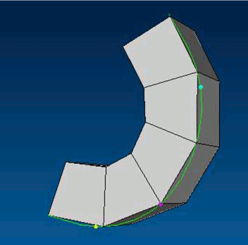

#Sweep face along curve
create node location 0 0 0
create node location 1 0 0
create node location 1 1 0
create node location 0 1 0
create face node 1 to 4
create vertex location position 0 0 0
create vertex location position 0 .2 1
create vertex location position 0 1 2
create vertex location position 0 3 2
create vertex location position 0 4 1
create vertex location position 0 5 0
create curve spline vertex 1 2 3 4 5
create element extrude face 1 layers 5 along curve 1
Figure 1. Extruding mesh elements along a spline

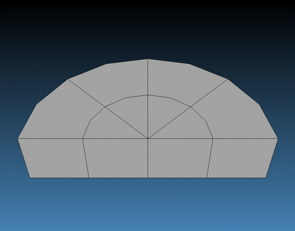

Elements can be created by revolving an existing element around a given axis. The Attempt_fix parameter will try to fix any poorly formed hex elements by collapsing them into wedge elements. Angle determines the amount of rotation around the axis. The Layers option determines how many elements will be created in the given rotation. The quadratic option will result in the creation of quadratic elements. For example, it can result in HEX20 or TET10 elements being created. To further specify the element type, for the created elements, one may put them into a block.
Create Element Revolve {Edge|Face|Tri} <element_list> Axis <axis_options> Angle <angle> [Layers <num_layers>] [Attempt_fix] [quadratic]
#Revolve 2 faces around the Y-axis and collapse inner hexes to wedges
create node location 2 0 0
create node location 2 1 0
create face node 1 2 3 4
create face node 2 5 6 3
create element revolve face 1 2 axis direction 0 1 0 angle 180 layers 4 attempt_fix
block 1 hex all
block 2 wedge all
block 1 element type hex8
block 2 element type wedge6
Figure 2. Revolving free mesh elements to create hex and wedge elements

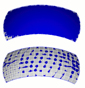

##Mesh and geometry overlap
refine face 1 radius 3
set developer on
## Smoothing free mesh is a developer command
smooth face all scheme laplacian
##Smoothed mesh is away from surface
smooth face all scheme laplacian target surface 18
##Smoothed mesh is aligned with surface
Figure 3. Smoothing without a target (above) and smoothing to a target surface (below).

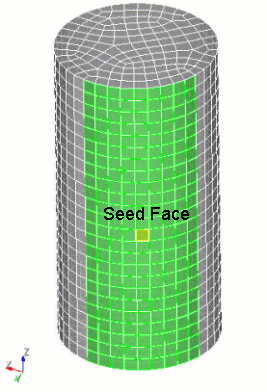

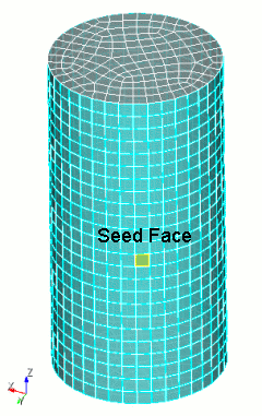

group 'mygroup1' add seed face 752 feature_angle 45
##Groups all faces on the cylindrical surface
group 'mygroup2' add seed face 752 feature_angle 45 divergence
##Groups only faces within 45 degrees of seed face
sideset 1 group mygroup1
sideset 2 group mygroup2
block 1 hex all
draw sideset 1
draw sideset 2
draw block 1
Figure 4. Grouping faces on free meshes using the seed method. The feature angle method is used on the left with a feature angle of 45 degrees. On the right is the result if using the divergence method.
