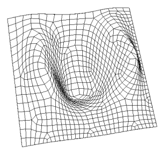

The Interval sizing function is similar to the Linear function, but bases edge length at a location on the squared lengths of edges bounding the surface weighted by their inverse distance from the current location. An example is shown below.
Figure 1. NURBS mesh with interval sizing function, 34 by 16 density
