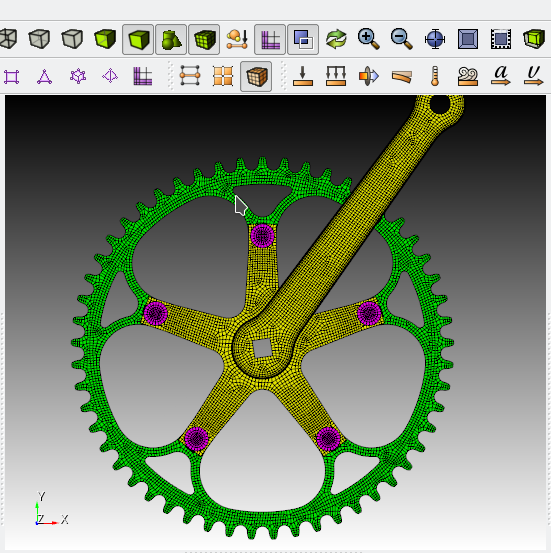

Graphics
Generally, the graphical features for lite meshes is supported at the same level as for heavy meshes, including the ability to draw, pick, select, highlight, zoom among other operations. The coloring of the mesh is based on blocks, and may be adjusted by the user. Toggling visibility of all sidesets and nodesets can be done by clicking the Display Boundary Conditions toolbar button or with the bc visibility {on|off} command. Toggling visibilty of all blocks can be done by clicking the Display Mesh toolbar button or with the mesh visibility {on|off} command.
The draw, zoom and select commands work on blocks, sidesets and nodesets. Also, selecting those genesis entities in the graphics window will result in them being highlighted in both the graphics window and in the tree. Selecting of nodes and elements has not yet been implemented for meshes imported in lite mode.
