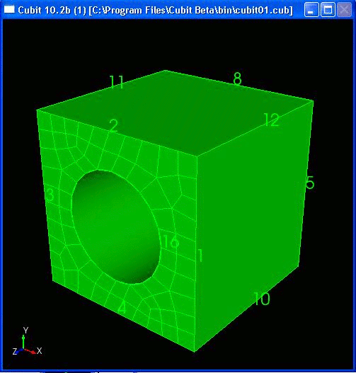

Now that all the necessary intervals have been set, the meshing can proceed. Begin by meshing the front surface (with the hole) using the paving algorithm. This is done in two steps. First, set the scheme for that surface to Pave; then, issue the command to Mesh. Since the surface to be paved is number 11, issue the command:
Coreform Cubit> surface 11 scheme pave
With the meshing scheme specified, we proceed to mesh the surface:
Coreform Cubit> mesh surface 11
Coreform Cubit>display
The results are shown below:
Surface Meshed with Paving
