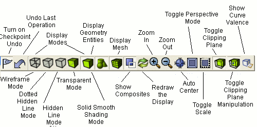

The type, quality, and speed of rendering the image can be controlled in Coreform Cubit by selecting one of the buttons in the Display icon group. These icons appear by default in the icon bar above the graphics window. They can be used to change the display mode to wire frame, hidden line, true hidden line, transparent or smooth shade.

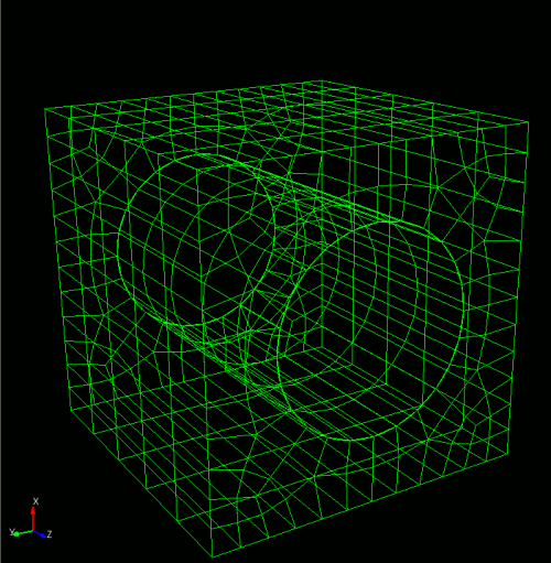

For example, the following two figures result from selecting the Hidden Line and Wire Frame Mode buttons respectively.
Hidden line view of mesh
Hidden Line View of Mesh
Wire frame view of mesh
Wire Frame View of Mesh
