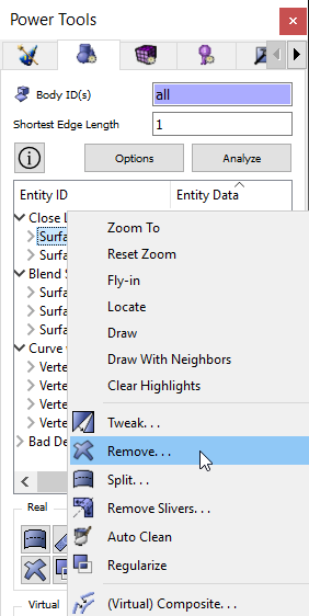

OR

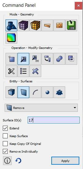

The Control Panel will appear under the Geometry-Surface-Modify- Remove heading. The Surface id should appear in the input window.

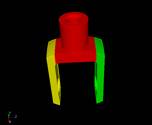

The small surface no longer appears.

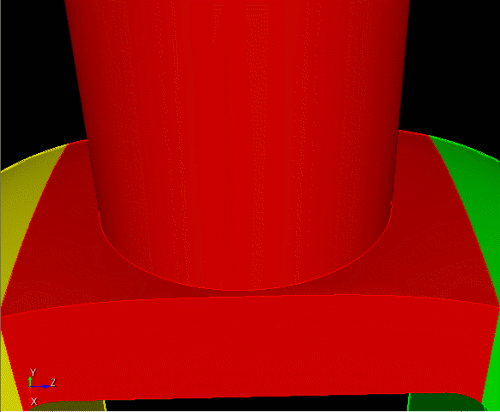

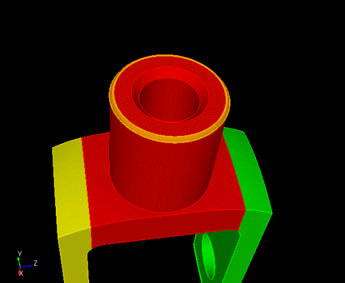

Surface 15 is shown highlighted in the following image.

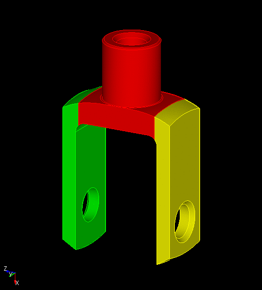

Reset the Zoom to show the entire model.
