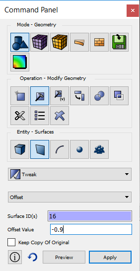

The Geometry-Surface-Modify-Tweak will open on the Control Panel as shown below.
Surface 16 is shown highlighted below.
The offset value is a percentage of the current size. Entering -0.9 will decrease the radius by 10 percent.

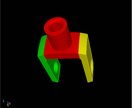

The graphics window should now look like this. Notice that the radius of the cylinder has shrunk inward, increasing the gap between the edges on Surface 41.
