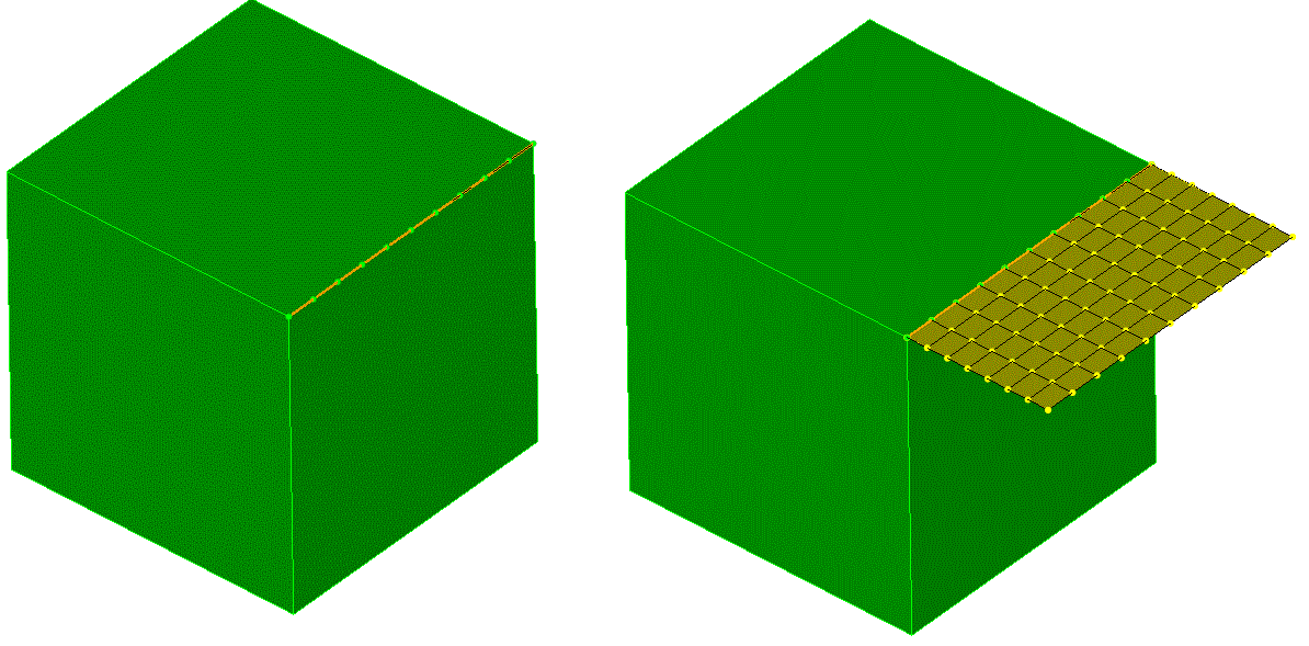

7. Offset: The following command creates surfaces offset from existing surfaces at the specified distances.
Create Surface Offset [From] Surface <id_list> Distance <val>
The surface offset command will only translate the existing surfaces, without extending or trimming them. An alternate form of the command for sheet bodies will maintain connections between surface by extending or trimming as they are offset, shown in Figure 1. On the left, the surfaces are offset using the surface offset command. On the left, the surface is created by using the "sheet" version of the command.
Figure 1. Offsetting surfaces to form individual surfaces or sheet bodies

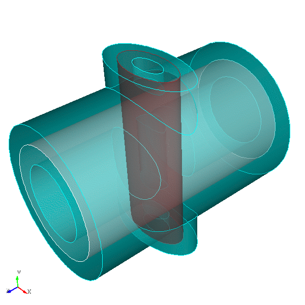

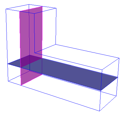

10. Midsurface: Multisurfaces may be created midway between pairs of surfaces using the following command:
Create Midsurface {Body|Volume} <id> Surface <id11> <id12> ... <idN1> <idN2>
where N denotes the number of pairs of surfaces. An even number of surfaces must be specified, and the command will group them by pairs in the order in which they are provided. The resulting surface will be trimmed by the specified body or volume <id>. This replaces the Create Midplane command in previous versions of Coreform Cubit.
Figure 2. Multisurface created with the Create Midsurface command
Figure 3. Midsurface created from 2 pairs of cylindrical surfaces

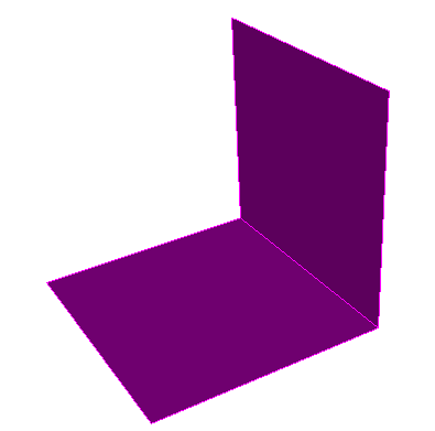

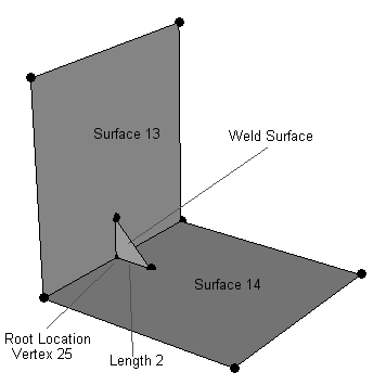

11. Weld Profile: Surfaces may be created by specifying a weld profile using the following command:
Create Surface Weld [Root] Location {options} Weld Surface <id_list> Length <val> [<val2>]
Weld surfaces can be used to create a simulated welded joint by sweeping the surface along the root curve and uniting the new body to the model. An example of the command is illustrated below. For a detailed description of the location specifier see Location Direction, and Axis Specification.
create surface weld root location vertex 25 weld surface 13 14 length 2
Figure 5. Weld Profile surface with length and root specifications

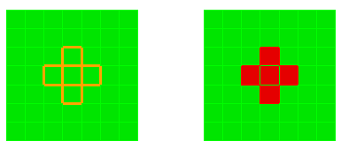

12. Creating A Surface From Mesh Entities: Surfaces may be created from the boundaries of meshed volumes, surfaces, and/or from individual quadrilateral mesh elements. The individual option makes it so you can enter multiple surfaces at once, and not have them merged together into a larger surface, but instead retain their own original boundaries. The optional tolerance value allows the user to specify a tolerance to which the resulting surface should be fit. The default value is 0.001. If surface creation fails, increasing the tolerance value can help.
Create Acis [From] {Surface <id_range> | Volume <id_range> | Face < id_range> [Individual]} [Tolerance <value>]
Figure 6. Acis Surface created from a Set of Quadrilaterals
