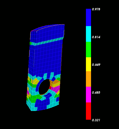

Draw
[ Draw [Histogram] [Mesh] [Monochrome] [Add] ]
If the user specifies draw histogram, then histograms are drawn in a separate graphics window. The window contains one histogram for each quality metric. If the user specifies draw mesh, then the mesh elements are drawn in the default graphics window. A color-coded scale will appear in the graphics window. The histogram and mesh graphics are color coded by quality: a small metric value corresponds to red, a large metric value to blue and in-between values according to the rainbow. You can grab the side of color bar and resize it.  The text gets smaller as the color bar width decreases.  You can also grab in the middle of the color bar and move it around.  It can be repositioned to the bottom or  top and it will automatically change orientations. See Figure 1.
Figure 1. Quality Scale
If monochrome is specified, then the graphics are not color-coded. If add is specified, then the current display is not cleared before drawing the mesh elements.
