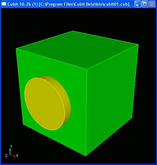

To interactively change the orientation, activate your graphics window by placing your cursor in the window or by clicking at the top of it (this will vary depending upon your window settings in your operating system).
Use the mouse buttons to make the display look the figure below:
View from a Diferent Perspective
View from a Different Perspective
