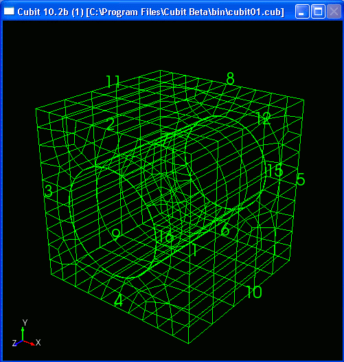

Coreform Cubit> graphics mode wireframe
The wire frame display is illustrated below:
Hidden Line View of Mesh
Wire Frame View of Mesh

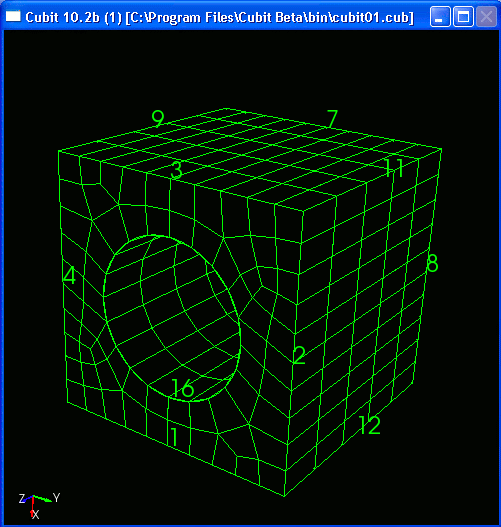

Coreform Cubit> graphics mode hiddenline
The hidden line display is illustrated below:

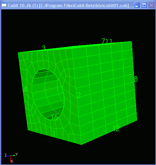

Coreform Cubit> graphics mode transparent
The transparent display is shown below.
Transparent View of Mesh

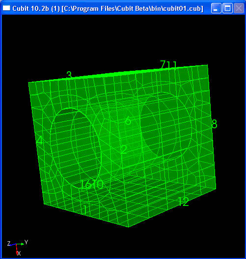

Next, try:
Coreform Cubit> graphics mode smoothshade
The smooth shade display is shown below. For detailed information on the viewing mode options, See Graphics Modes.
Smooth Shade View of Mesh

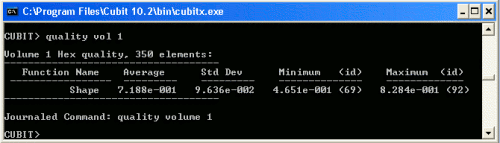

Although Coreform Cubit automatically computes limited quality metrics after generating a mesh and warns the user about certain cases of bad quality, it is still a good idea to inspect a broader set of quality measures. To do this, enter the command:
Coreform Cubit> quality volume 1
The results of the quality output are shown below. For an explanation of quality metrics along with acceptable ranges, see Mesh Quality Assessment. For the purposes of this tutorial, you can assume the quality metrics shown below are in an acceptable range.
Quality Table from Volume 1's Hex Mesh
